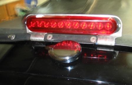

I wanted more visibility when braking my 1958 TR3A in the dark. So I fabricated this, had it chromed and intalled it. I is about a foot long and shines much brighter than the tiny ones which are sold in California from a well known TR, MG and Miata parts supplier.
Mine does not have any visible screws or holes, it doesn't interfere with the re-fuelling cap and the attachments are hidden under the edge of the top or the edge of the tonneau cover. It takes about 2 minutes to remove before the TRA or VTR judges arrive.
Other TR drivers following me have said it is much brighter than a sidescreen TR without this light.
