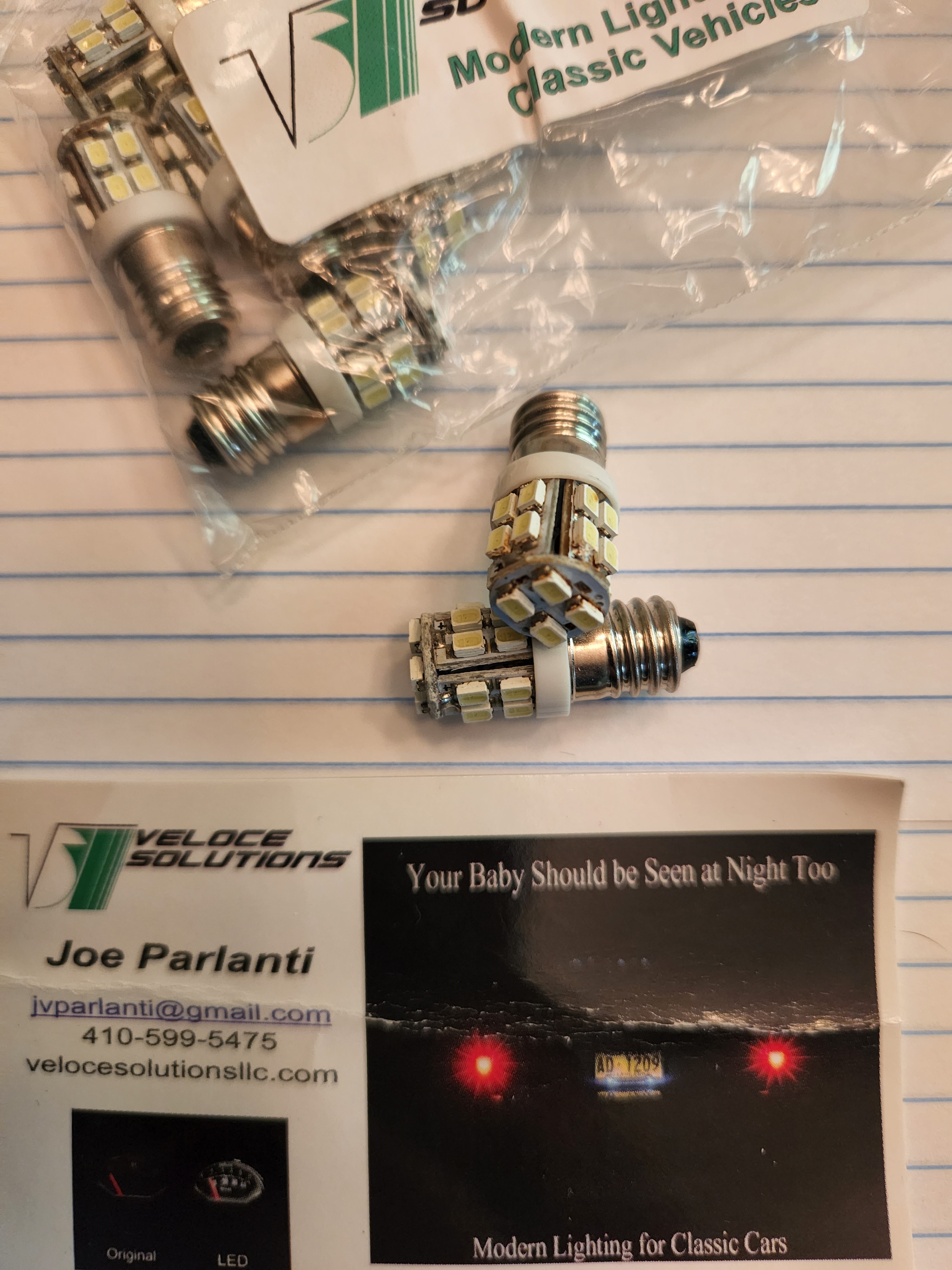

I got inspired, looked around a lot and finally found some 'bi-polar'--that's what the ad says--LED E10 lights for the dash indicator lights. They're definitely brighter, but there's a problem: the on/off interval is erratic (the flasher can sounds normal). I think this is because, if you'll recall, early on in the LED days it would take a half-second or so for the LEDs to light up. My house is now almost completely LED, and some fire instantly but some still take a fraction of a second to light up, unlike an incandescent which starts to 'burn' instantly. Because of this, I theorize, the lights fire and go off at differing intervals. It's kind of distracting and annoying but I'm gonna try to learn to live with this, if for no other reason than it's a real PIT back to replace them.

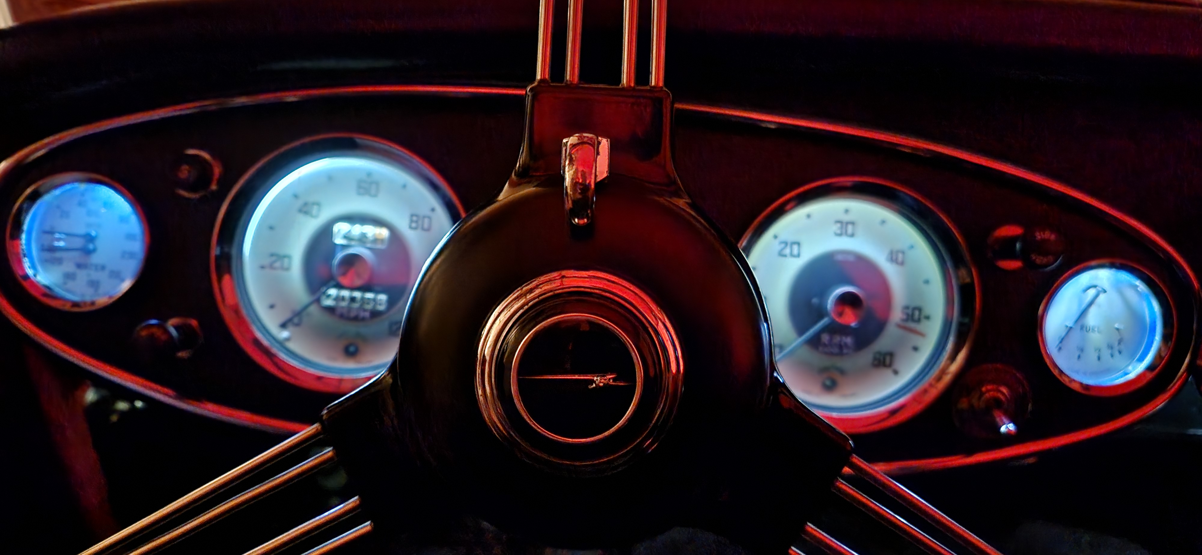

My BJ-7s LED gage illumination solution and results. Red halo is reflection from rear parking lights also LED converted. No resistors required from this source.
