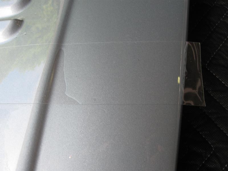

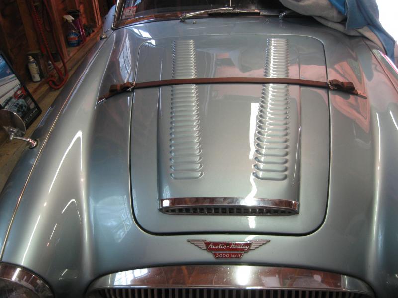

I noticed some paint chafing on the bonnet from my leather strap and when I had the hood repainted after the louver addition I added some XPEL protective film: https://www.xpel.com/ It was an easy enough project, took about an hour, and total cost was under $10. It's pretty much invisible and the only other solution to chafing I've seen is lambswool under the strap that I wasn't too keen on.
During installation before the soap solution was squeegeed out:
Finished project:
That protective tape is pretty amazing. I've applied a 1" strip of it under the Tenex studs around the cockpit edge for protection from the tonneau cover and wrapped it around the bonnet and trunk prop rods where they snap into the rubber holders to prevent the paint from wearing.
I'd think it would be great for under the leather hood strap, where it won't be exposed to the sun. In some of the other areas mentioned, the paint will fade differently underneath. Like carpet runners, a different set of problems are created.
