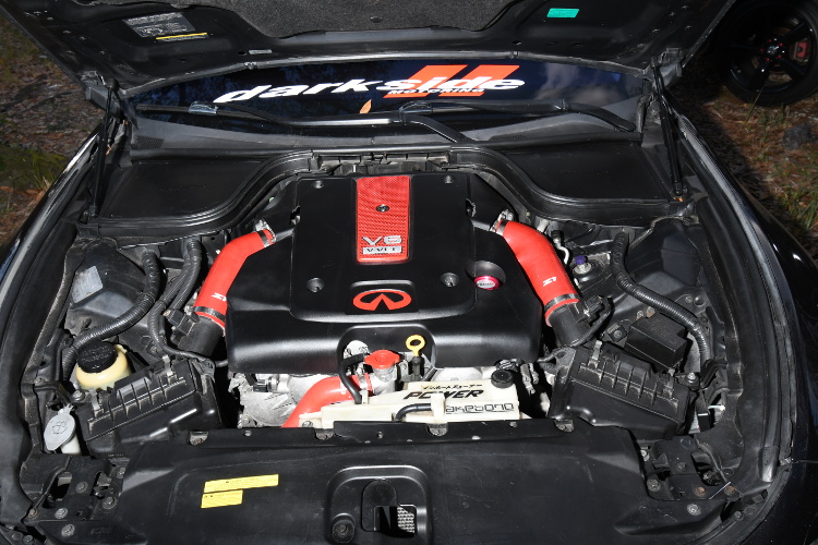

The G37 engine bay after all the work and some added bling and paintwork:
