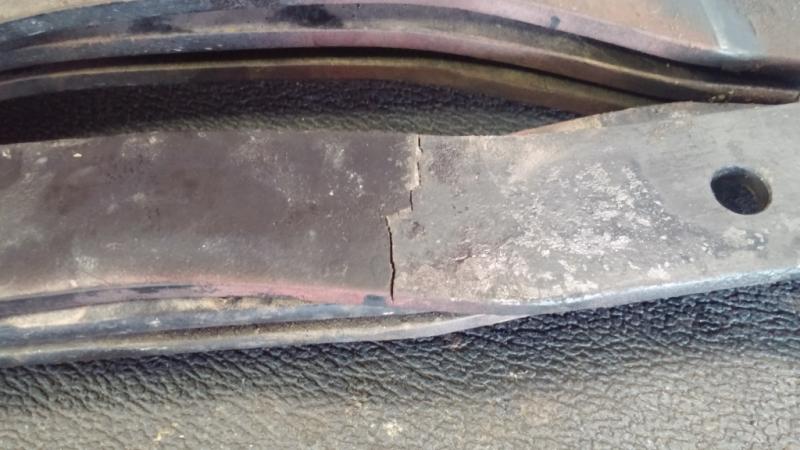

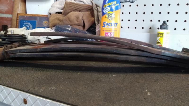

Today I tore into it and this is what I found...
The good spring is behind the clearly cracked bad spring. Guess 2 of 3 leafs could cause a 1" sag on one side :smile: I sent in the broken one and the opposite side to Morris Springs in Stockton to see if they can recreate the broken leaf. Keep your fingers crossed!
