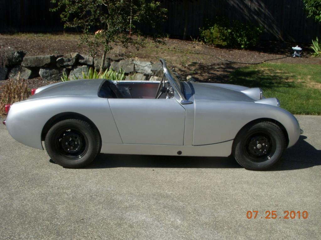

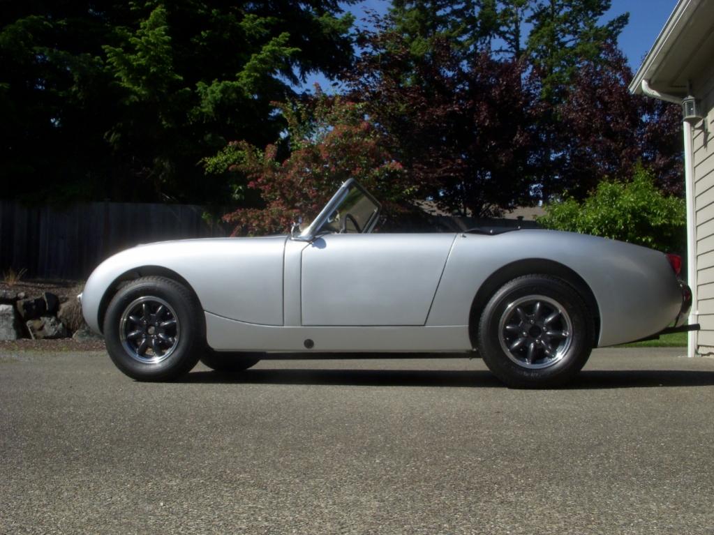

I put in 3/4" spacers when I put my car together. The springs had a 1" drop I think. With stock wheals they rubbed the inner finders some. With the new wheals they rubbed inside and the bonnet. When I took the spacers out it raised the car about an 1 1/2" at the rocker. I guess I got to cared away. DSCN5247 (1024x768).jpgDSCN6663 (1024x768).jpg
