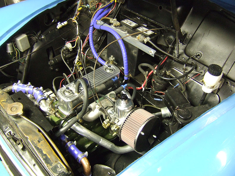

Drew, If you'll be removing the Weber in lieu of SU carbs, you'll be better off with a single SU, either and HIF44 or HS6. They will perform better than twin HS2's and be much less maintenance. I've done that setup on several MM's and also on my A35, and there is a noticeable difference over HS2's I've removed from the same cars.
attachment.php
Thanks, Gerard. Was wondering about doing a single SU for this one. Now I just need to find the carb and manifold...

Drew, I believe your PCV is set up to feed just the front port of your head and likely leaning those cylinders out WAY too much. Try plugging that inlet and letting the PCV vent to atmosphere to see if it will run better. If it does you can make up a restrictor for the line or continue to vent to atmosphere.
Kurt.
Thanks, Kurt. I'm swapping out that Weber anyways (for a single SU), so I'll be figuring out a new PCV concept with the new manifold. Good to think about, though -- I'll make sure to keep that in mind when I'm setting up the SU.
