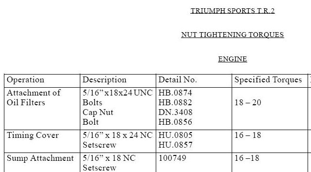

the last time I reinstalled the oil pan, I torqued the bolts about 10 ft. lbs. This seemed a little light to me, but it is what is called for. What do you think?
Which book is that? The factory workshop manual says 16-18 ftlb. I wouldn't go any higher than that, as it just distorts the pan and splits the gasket, making things worse instead of better.

(this scan is from a TSB, but it echoes the information in the workshop manual)

I would think that 16-17 lbs would be OK for tightening, but I can't imagine that a little extra should hurt unless the bolt holes start to dish up so easily. Maybe the old steel is just too weak.
As for that front middle bolt that goes into the front aluminum sealing block, I'd be afraid to strip that above 14 lbs or so.
