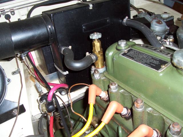

So, do you recommend applying the packing to the bottom of the valve, where the wet part is in this photo???
You can see where the water is coming out, at the brass part just below where the knob sits:
[img:center]
[/img]

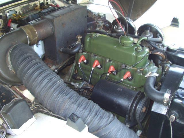

Yes, if I am remembering this correctly. you have removed three parts at this point.
1. the wheel handle.
2. the the screw
3 the nut that pushes the packing down into the part where it is wet.
Here is how this works. additional gaskets at the bottom to make the connection for the hose come at the right angle.
The nut right under the handle wheel compressies the packing down around the shaft to seal the fluid in. Not too tight, just enough please.
I hope you have the nut part??

Jack, your valve looks different. As you can see by comparing the photos, yours is taller and has the "nut" part you're talking about. Mine does not, and it isn't indicated in the Moss catalog, either.
Mine's a '74 MK III. Different animal, maybe? Your solution may not work on mine. What do you think?
According to the parts list the same heater valve is used from 1958 thru GAN-91407, 1974.
The next valve is an automatic one.
May I suggest you have a peice missing from your valve. See the nut under the wheel on the stem on mine. That nut has a collor that pushes the packing down and makes it tight.
I think you are missing parts.
Has it always been like that or what?? Where is the handle/wheel?
Hay, moss is selling em for 29.95, it might be time if you have peices missing.
Or maybe some one on the list has one they would part with.
