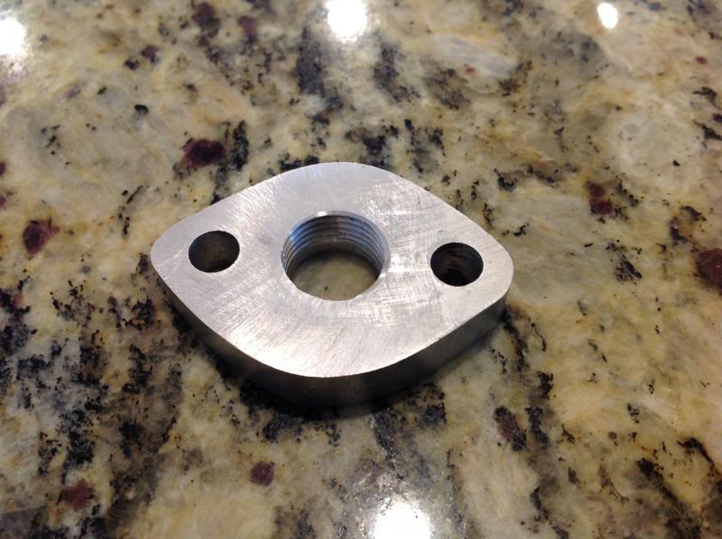

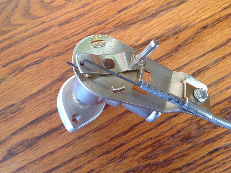

Do TRs have the same problem as MGBs in that their heater valves don't last very long or the leak and don't have a positive shutoff? I put this together for my MGB and it stopped the leaks and gave me more heat as well as better control over the valve. Please let me know your thoughts.
Thanks, Rut

poolboy
This looks like the same. I know a bunch of us TR6 owners replaced the original valve with it.
