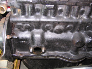

I don't remember if you said that you already checked or not that the 1275 actually has a hole under the blanking plate- I have taken the blanking plate off of a couple of 1275's to find that there was indeed NO hole there for the fuel pump. Just curious.
Bill
Now I'm curious too! I thought "If it has the plate, the hole's behind it." but now...
If the plate's there it will fit the Tunebug's block, too. The low pressure electric pump should be okay for all the SU's. It eliminates the possibility of hosing down your crankcase oil with gas, and the expense of rebuilding/replacement of that "whiff 'n poof" mechanical thing. I see no compelling reason to keep it, as the 1275 plan renders "originality" moot.
I admit, I never checked under the plate. I'll have to look now when I get home. Now I'm curious!

Verdict... there is a hole! This is the 1275 from the Midget, and there is a hole under the plate. This is a late 12V 671 block.

Since you do have a hole there and will be using the electric pump then you have a good extra place to vent your PCV system if it is so required. Just keep it in mind- don't do it until you need it.
