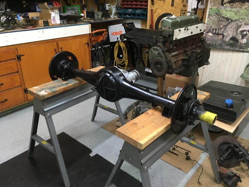

was expecting to be asking a lot of questions this week about putting this car back together.... but i ran in to a few issues with Lilly. As much as i checked and prodded i did not find the rust issues on this car until i was painting.
three spots popped up after some bead blasting. actually a couple i did not see until after painting which is a little weird.
one in front of the right rear wheel on the inside. just a little rust right at the very bottom. i cut it out and replaced with new metal. not a hard job... well except my welding skills are not the greatest. but i do handle a grinder pretty well. trouble is you can not get a grinder or much of anything up in that spot. i ended up using a dremel tool for the cutting and the grinding. took a while (see part about welding skills) but i got it replaced. good news was everything behind the inside piece was solid. i cleaned as much as i could in there and sprayed with a rust remover/encapsulator before i put the new metal back in. painted and all good to go.
second there was a piece at the back of the floor pan on the passenger side the po had told me they had replaced. i assumed that meant they had welded in new metal. but instead they had epoxed a piece of metal over the hole. not a real structural place but it looked like the devil from under the car. they had drilled holes for the epoxy to bit in. so under the car you saw all these bubbles of glue and a 2" x 5" hole with a cover on top. after paintying it got the best of me so i cut all of that out and fixed that. sure takes a while to weld that thin sheet metel and get it all flush and clean. but job is done.
third place was the inside corner on the driver side of the floor pan right where the drive shaft tunnel starts. that is going to be the tricky one. not a big hole at all but it is right on the corner. too big to just lay weld in but not big enough to really make a piece for. not sure what i am going to do with that just yet but i hope to come up with a plan shortly.
i did get the frame blasted and painted. it was a real pain with the car already painted. boy that glass bead gets everywhere. lots of showers this week. but it came out pretty nicely. i decided to do the wheel wells in black but paint the rest in the car color. got some touch ups to do but at this point i want to get all the rust issues out of the way and do one touch up.... i hope.
also got the rear end blasted and painted ready to go back in the car.
everything feels really good with the rear. no real play, no clunking and the outside wheels bearings feel really smooth. So i am just going to put it back in as is.
