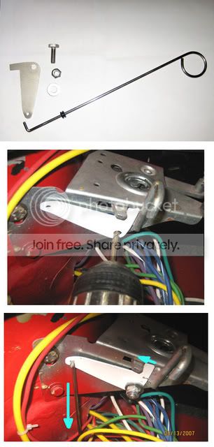

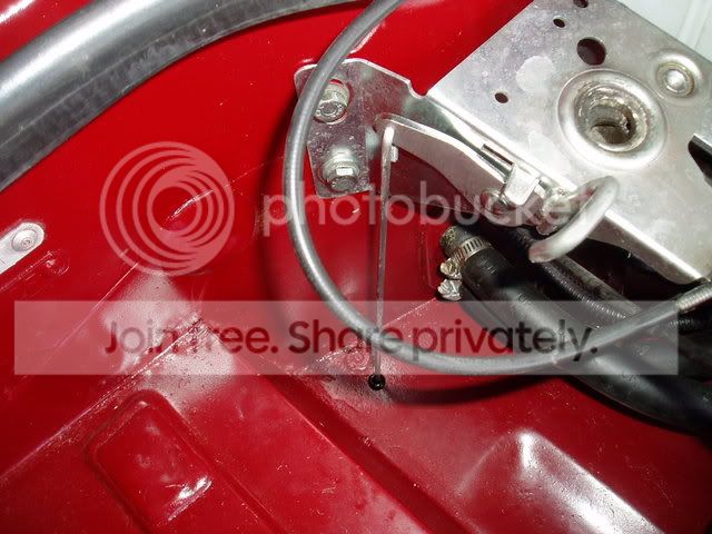

I installed my bonnet/hood release mechanism today.
Looks like this:
Before this install, as an early TR owner, the hood release
failed and I had to drill into the firewall (bulkhead) in order to disengage the latch mechanism on the hood. An
experience I'll never forget.
I want to thank the Forum members generally; and
Dale, (Tinster), specifically for posting the following
great pictures in order to assist me with my purchase
and/or install. The pictres that aided install are as
follows:

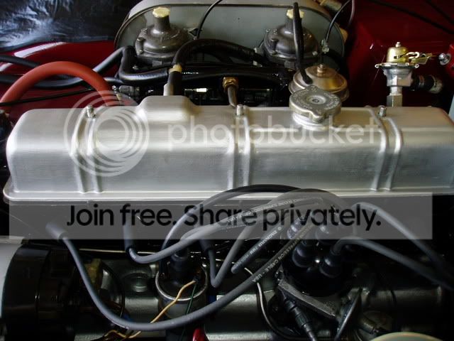

I show you my valve cover, only because I have to
tell you that I backed off screwing the three valve cover
long threaded studs counter-clock-wise until approximately
a half-in of threads were showing at the bottom where they
screw into the head/block. This was to accommodate the
hardware necessary to install my Justin Wagner vavle cover
gasket.

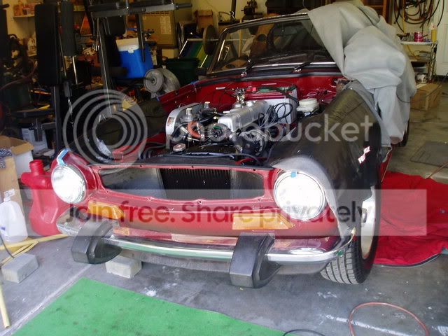

Crawling to the finish line....
My car looks like somebody in intensive care; propped up
with IV's draped and all...
