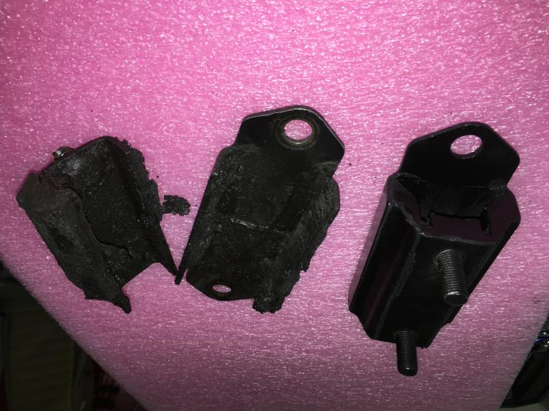

I have a late number TR4A and this car has an unusual bracket on the rear of the gear box immediately forward of the rear drive shaft seal and bearings.
1) Some form of a counterweight immediately rear of aft gearbox mount
2) There appears to be a switch of some form that detects REVERSE.
3) This was taken apart to replace the aft gearbox support bracket
Not sure if previous owner (original owner) installed this.
Has anyone seen something similar ??

The weight is factory. I don't have my SPC handy, but I've seen it in there, and I've got one just like it in my parts bin.
The switch appears to be a DPO-ism.
I removed such a weight/ dampener from a solid axle TR4A. But have never seen one on any other TR.

Weight is suppose to help reduce vibration. Throw it away. Second picture whats left of rear trans mount. Throw it away. Third picture looks like PO was trying to do his own version of back up light. Throw it away. Last picture I can't tell much about it. Is it another picture of third picture? Throw it away LOL
Marv
Pic 1 is a vibration damper weight.
Pic 2 is whats left of rear transmission mount damper.
Pic 3 was a switch detect when reverse was engaged - was not wired up to anything.
Pic 4 was switch installed.
Keeping the damper weight for now.
Switch and mounting hardware was removed ... I will ask DPO (dumbass previous owner ?)
The rear transmission mount was replaced - it was just cumbling in place.
