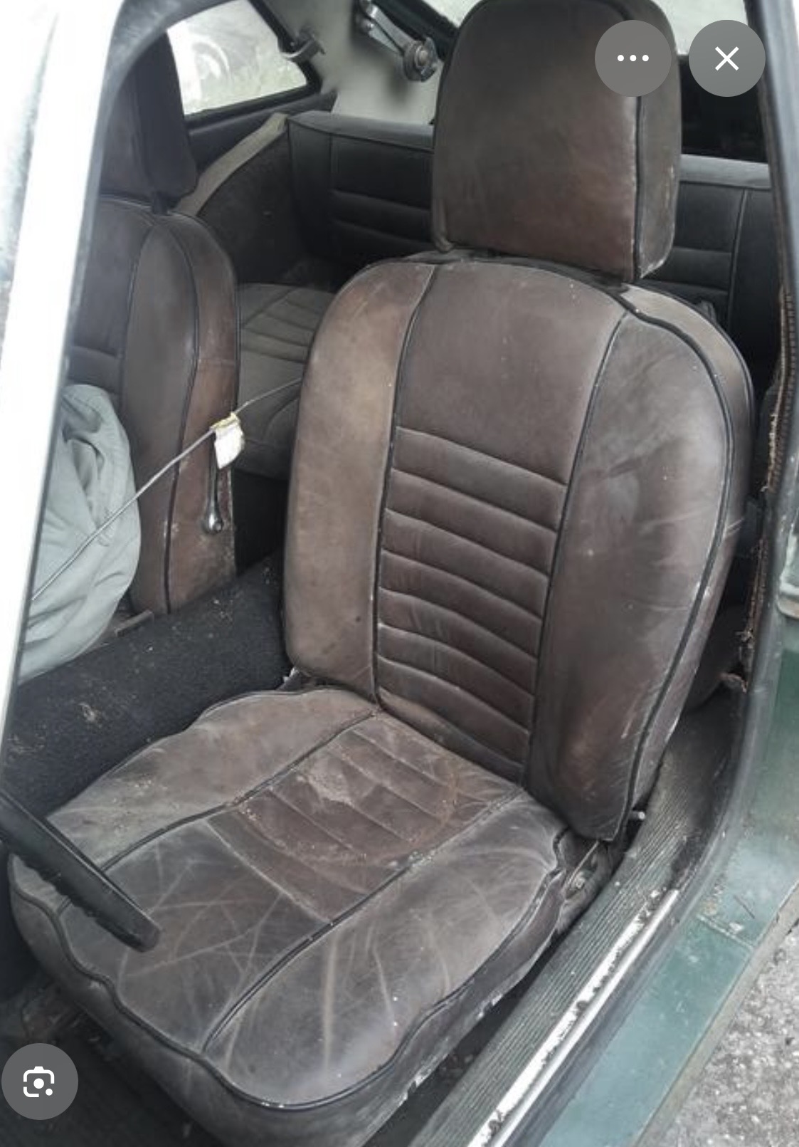

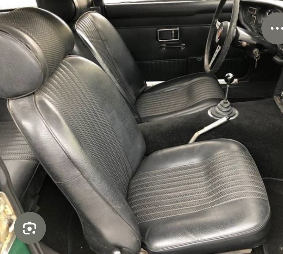

The ‘69 B came from the factory with the ones on the left, and in ‘70 they went to the ones on the right.

I thought that was the case. Do you think that the frame is the same for the 69 and 70, except probably for the seat foams?
Thanks
Kevin
Would think that most of it is the same, minus the head rest. I believe these are a 1969 issue only, and very ugly.
