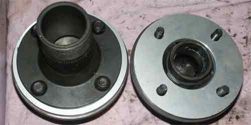

I did this on my Jamaican - MGB front hubs which normally carry 1/2" studs - found some 7/16" I could press in.
You normally need to cut down the stud lengths on a TR or SP250 so the ends of the studs don't foul on the under side of the wheel. I opted to make up thin disc spacers so that if I ever wanted to go back to bolt on I wouldn't have to change the studs again.
Pic of my hubs with spacers
