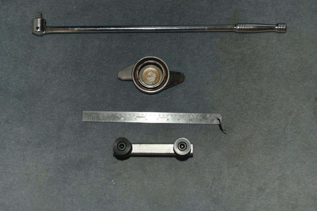

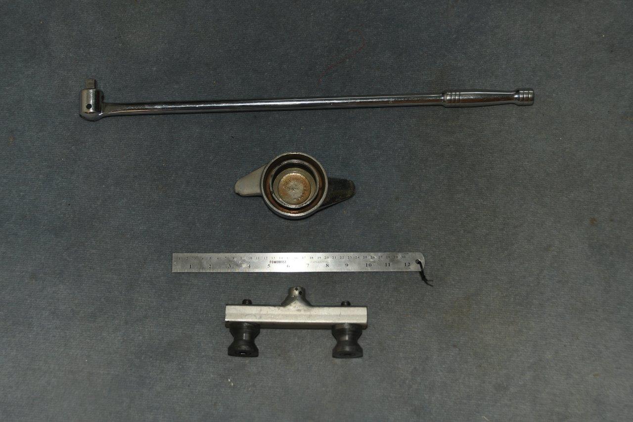

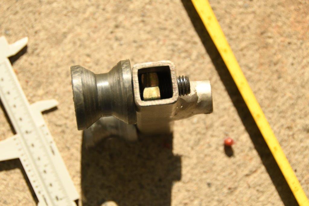

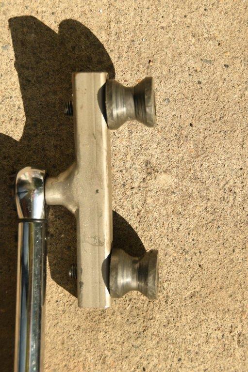

Friend Jeff has built a tool to fit the knock-ons and to use with a 1/2" drive breaker bar (and a snipe). He machined the rollers out of Delrin and counter sank the allen headed bolts. The BJ7 is tucked away for the winter so we won' t be really testing it out until Spring.

Based on the struggles we've had, the regular breaker bar won't be long enough. Next spring, I'll measure the maximum length for a piece of pipe that will slide over the breaker bar and still fit into the 'boot'. Plus see if it'll be a two person operation (one keeping the tool centred on the knock-on, while the other person pushes down on the snipe.

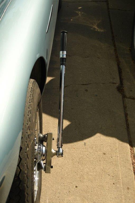

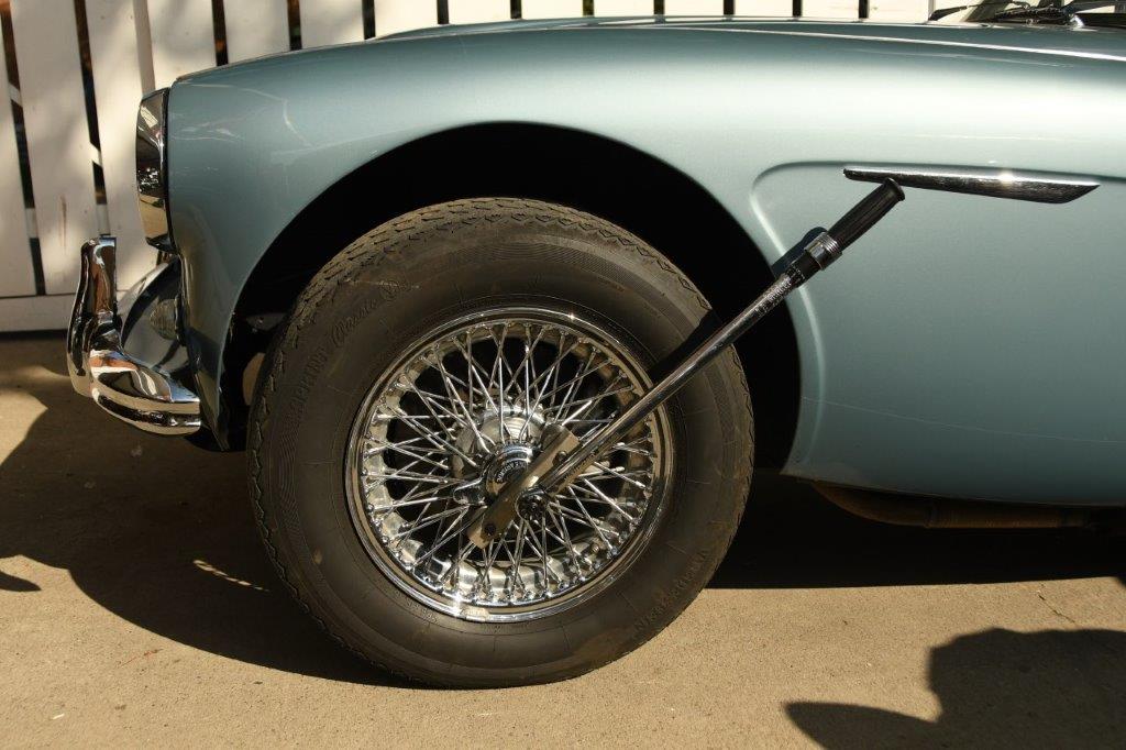

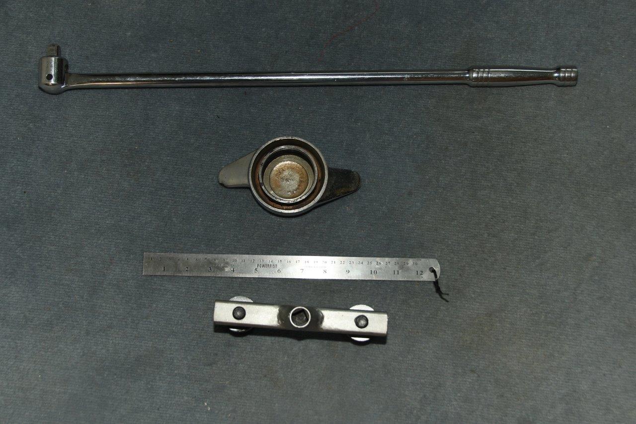

We used Jeff's tool a month ago - and it took the two of us to break a couple of the knock-ons loose. Hopefully the photos are self explanatory. The 'ratchet' is a busted 1/2" drive torque wrench, and the rachet mechanism still works - which is great! One real advantage of the failed torque wrench is that the connection to the tool is rigid - a regular breaker bar will allow the handle to pivot away from the tool, and it would be worthwhile tack welding/gluing the 'pivot' in place. I still want to pick up a 3 ft chunk of steel pipe, but expect to have to go to a metal yard to get one that will fit over the handle. Drop me a note if you want the full sized photos. And if I don't get back to you in a week or so, it's because I can't figure out how to open/respond/whatever, so add a note to this thread.

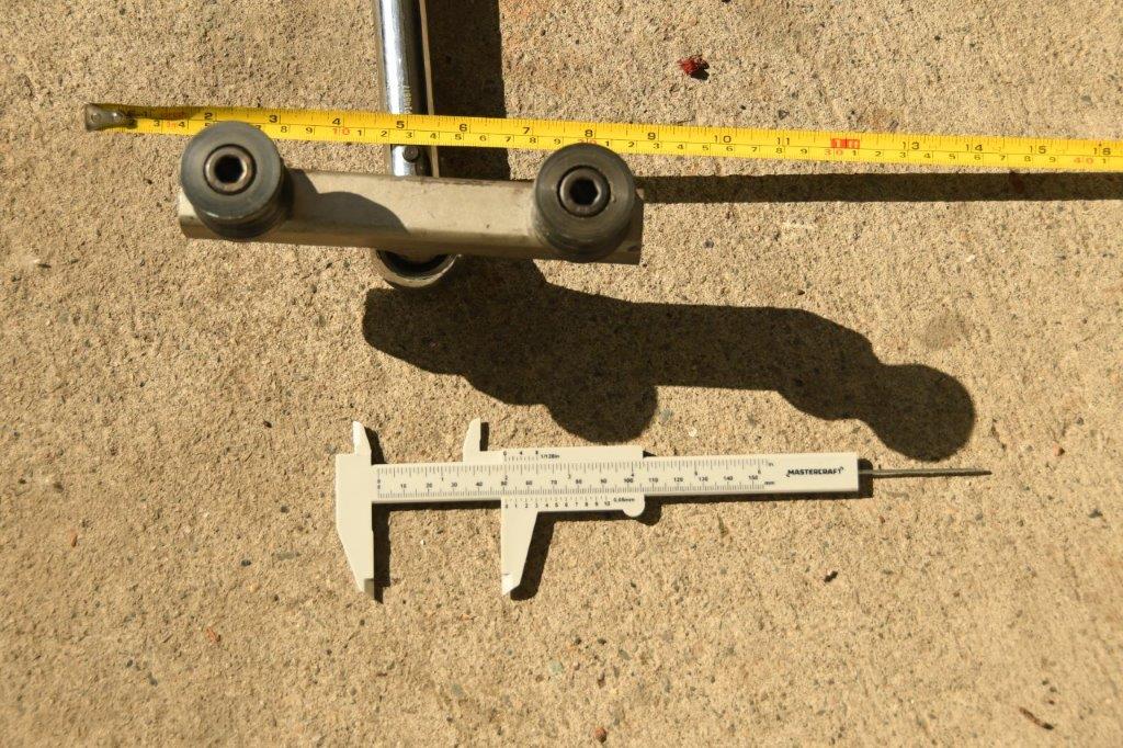

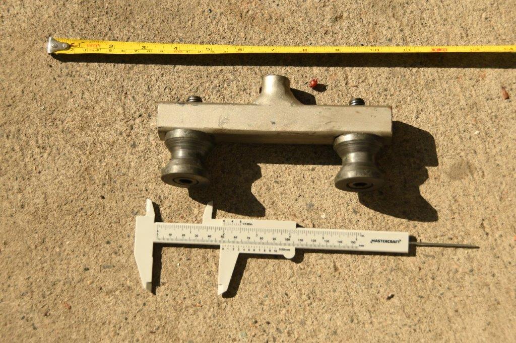

Attached are a series of photos of the tool that Jeff built, and that I'm pretty dang happy with. (I feel like I've already posted these comments but didn't find them, so apologies if I'm being redundant. A couple of notes:
- I'm using a busted 1/2" drive torque wrench that still works as a large ratchet. I still haven't picked up a piece of pipe to use as a snipe. If you dedicate a breaker bar to something like this, you might want to glue/tack weld the thing into a solid 90 degree bend so there's no flopping around
- the rollers are machined out of delrin (and they don't actually rotate)
- drop me a note if you'd like more detail. And if I don't reply, throw a comment in here please as I am sometimes digitally challenged.
Doug

The rollers look like motorbike "Bobbins".
Dang! that might make building a duplicate a lot simpler!
