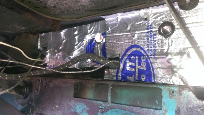

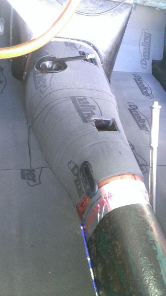

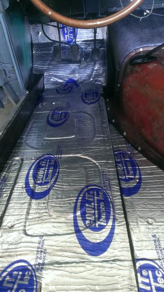

My car was unbearable to drive because of the heat in the cockpit. As already mentioned check the firewall for leaks and the transmission tunnel heat shield. In my case the heater valve was on creating heat.
I installed heat shield on the firewall, footwells and floor boards. Then used 1/2" dynomate insulation which made a huge difference. Now the car is enjoyable to drive.

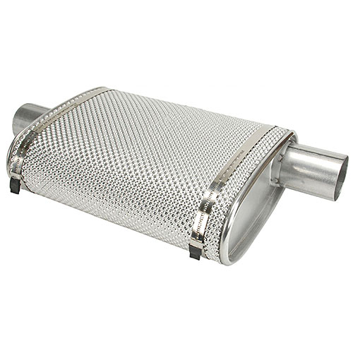

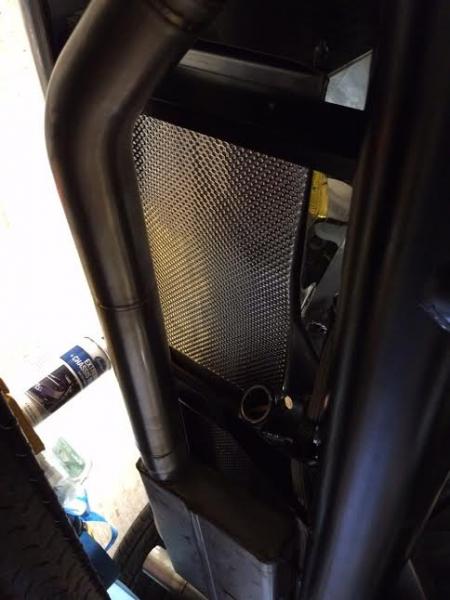

I've mentioned this in another thread, but DEI heat shield is amazing. You can use it on the footboxes and where the exhaust runs under the car. The more heat you can keep from entering the metal floor boards and footboxes the better. Kirkham Motorsports uses some sort of gold foil, but it is out the roof expensive. On my 289FIA Kirkham Cobra, I used DEI Floor and Tunnel Shield and also wrapped my mufflers with DEI muffler wrap. Then I used fat mat on the interior. I plan to do the same on my 100, but hopefully i can get away without using the muffler wrap.
