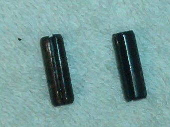

When the car came back from the engine shop - these two split pins were in the bag. I presume they are the guide pins for the intake manifold - any ideas? (they are 3/4 inch long)

They look like the manifold guide pins to me.
And I will confirm 1-3.
/bcforum/images/%%GRAEMLIN_URL%%/iagree.gif 1 thru 3
No clue on the pins.
Pins appear to be the nifty li'l guide pins.
