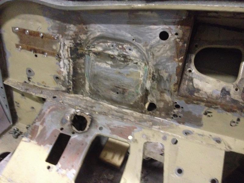

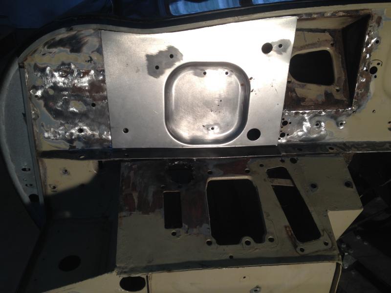

Monocoque Metalworks is enthusiast owned and he just specializes in E types. I bought a repair panel for the firewall ( to repair damage due to an old dealer AC installation). Perfect.
attachment.php
attachment.php
attachment.php
This is the first patch panel I've ever used in 40 yrs. that didn't require any trimming to fit and is accurate down to the relief pressed into it and the welded nuts on the backside. He just started making these and it will make for a great repair. A crude patch had been brazed in and bondo'd up and of course we can't have that on the Jaguar !
