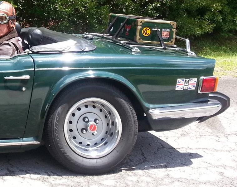

I also have 205/70s on stock wheels, primarily (or at least initially) because of they way the fill out the wheel wells. Which is also a common dislike of the size. I've come to appreciate them for their precision and stability, at the cost of a slight loss of nimbleness. But then that could be the tires...Bridgestone something or others.
attachment.php
