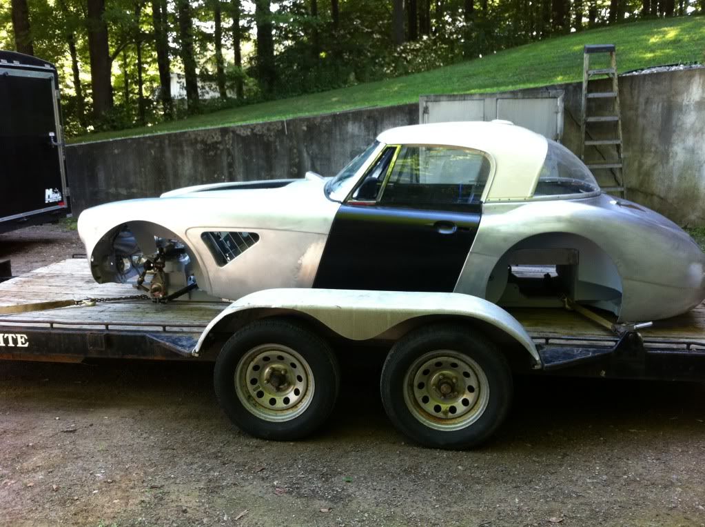

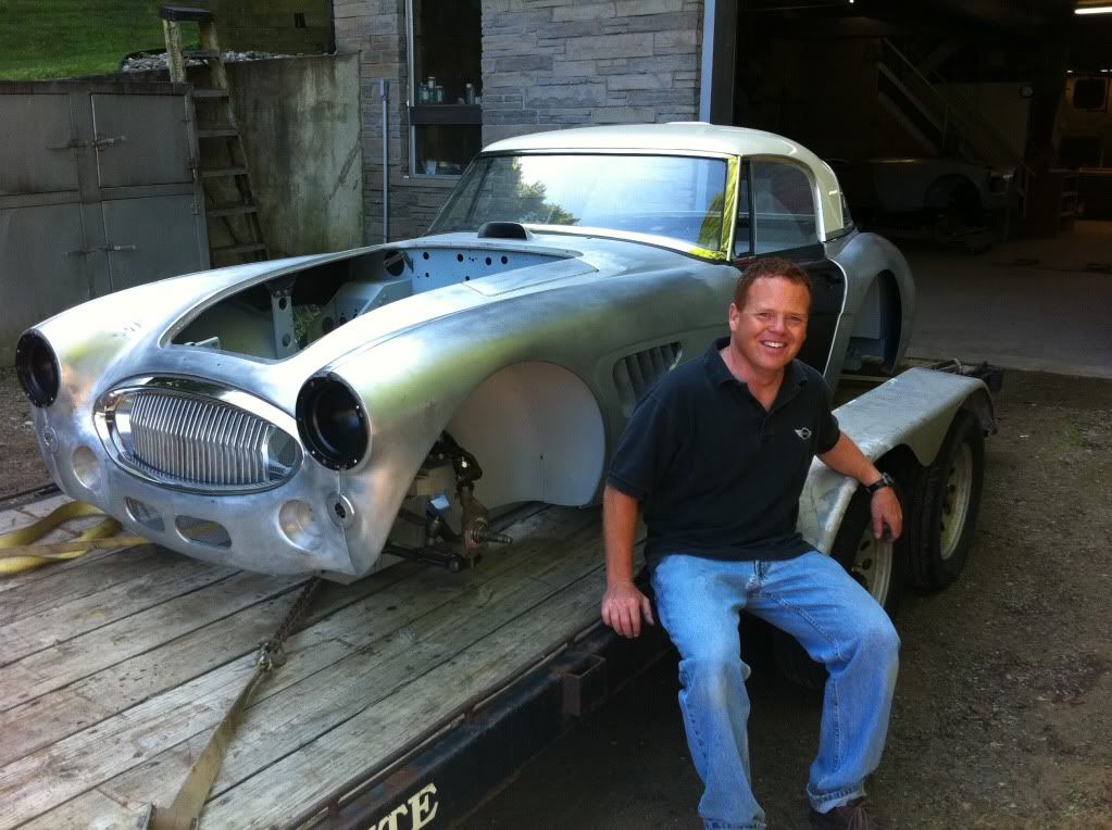

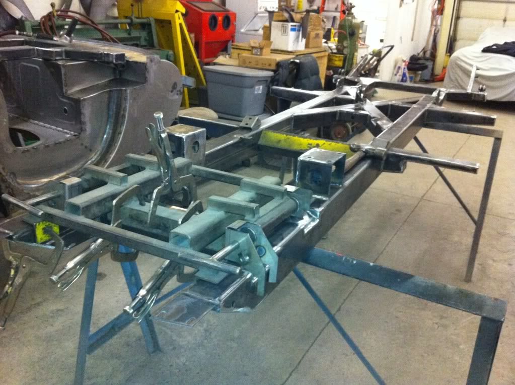

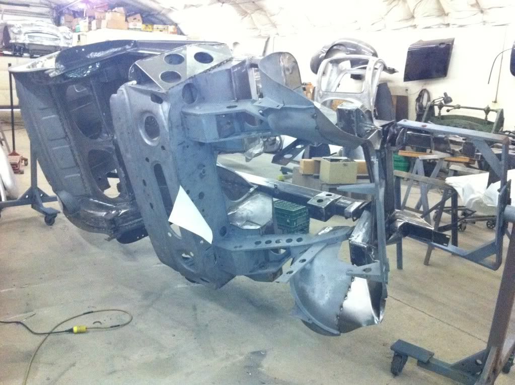

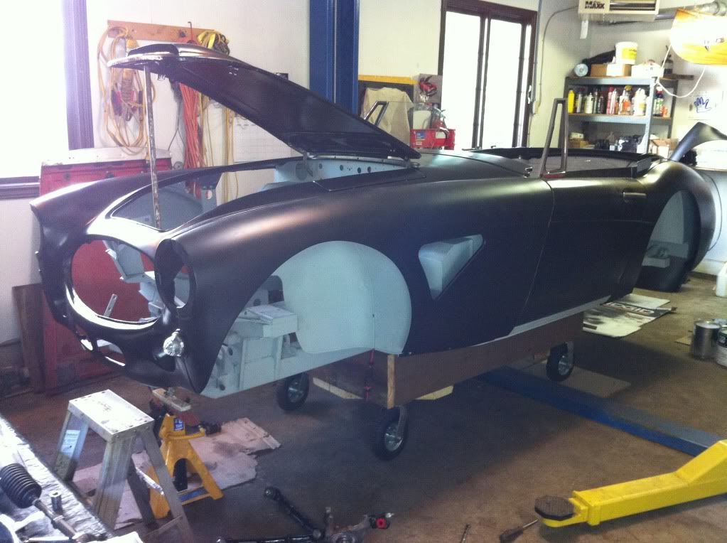

Here are a few pics of my BJ7 Sebring Tribute Car
The first two show the Jule frame , (May 2011), The next pic. is me bringing my car home from the panel beater. The two old guys ( LOL) not really but older then me are Marty on the left and Don. The last picture is epoxy primer in my garage (sept 2011). I have nothing to report other then the product is excellent and the service was the same.
Cheers Phil

Hate to be too petty but Phil failed to mention that it took a lot of effort, finesse and the talents of the nameless panel beater, Colin Bailey, (our own panel beater) to make everything fit well and properly, not to mention the mods Phil wanted.
Your's is the only other Healey that I've seen w/roll-up windows on a MK1 chassis. Surprisingly the glass fit the top & wing vents matched the windscreen. In 1970 I did that to my first Healey, a '60 2 place. I was 19 & took doors & latches off a '63 BJ7.I hated the rattles of the side curtains, plus I installed a built tri-carb engine & with adapters put on E-T mag wheels(I use to auto-cross)& couldn't afford wire wheels(college student). I've often wondered what happened to my first 1960 black 2-place, really loved that car,that was about 15 Healeys ago! cheers & Merry Christmas!!

It is a 1963 BJ7, Mk11 to car.
FYI -As Rich posted I took my car from Martins frame shop direct to Colin Baileys Panel Shop. Panel Beater Colin did all of the body metal work and the Sebring mods, without Colin, Martin and Rich I would be lost. I would love to share my pictures with everyone, the metal and frame pictures to me are fine art, really need to create a website to show my cherished Healey.
