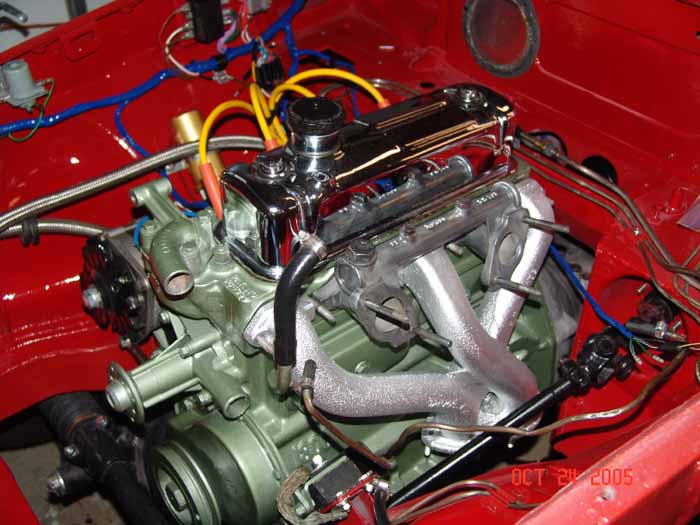

I used their Sterling finish over an LCB from Winner's Circle. Price for the coating was $165. Oh...turn around time was about 2 weeks.
Ray

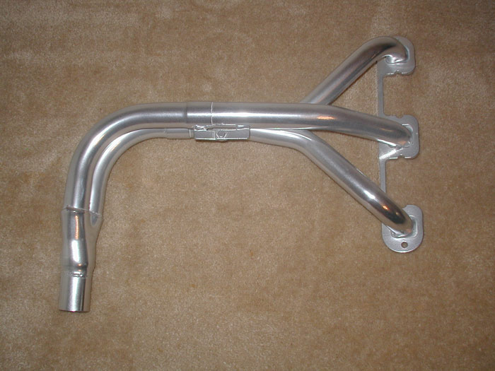

I had my exhaust and intake headers Jet Coated in sterling on my B. They are beautiful and have held up exceptionally well. It's also dramatically cut down on heat.
