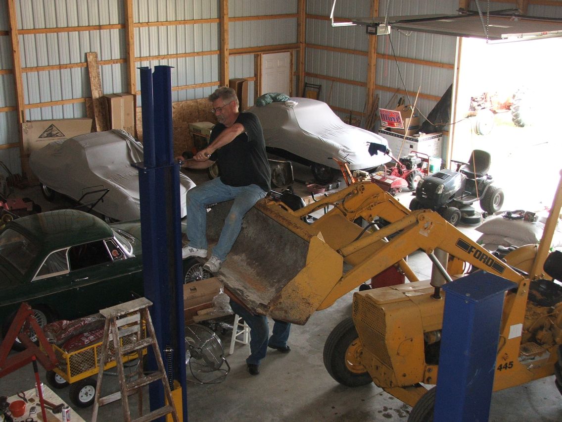

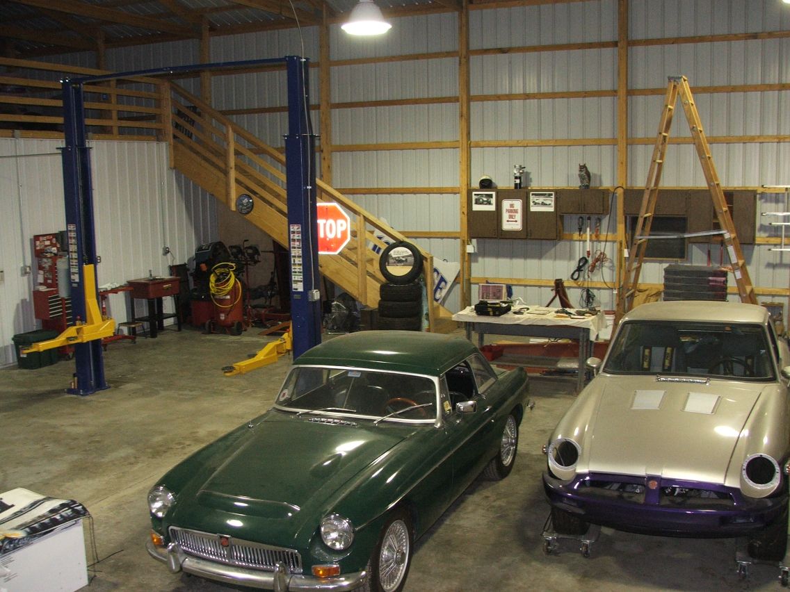

Got mine from Eagle Equipment ( https://www.eagleequip.com )delivered to my property for $1699 including s/h. Installation took the equivalent of one afternoon. I installed it myself with the help of a friend. Mine is the GLO-9A with overhead cabling and a 220v motor. The GLO-9F uses across the floor cabling and can be put into a garage with a 12' ceiling.
