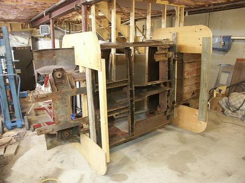

Jack's progress reports inspired me to give an update on my progress. Tony sent a bunch of sheet metal and this is the current state of affairs. The car looked a lot better before I stripped the bondo, some 3/4" thick in places. The car was so bad that I opted not to dip it - just seemed a waste since so much will be replaced anyways. So for all those that are discouraged with your project progress don't be...it could be worse. Body items to be replaced:
Inner and outer sills both sides
Floors
Rear bulkhead
Right spring hanger
Left rear quarter panel
Rear deck
A pillars both sides
Cross member left side
/ubbthreads/images/graemlins/lol.gif or /ubbthreads/images/graemlins/cryin.gif, I choose /ubbthreads/images/graemlins/lol.gif

Must be nice working in your basement?
Is it a walk out? If not how did you get the car down there? /ubbthreads/images/graemlins/confused.gif
making that corner from the stairs wasn't easy I'm sure - hehehehehe /ubbthreads/images/graemlins/jester.gif

Yes it is a walkout basement. I'm still building the garage and there isn't heat in there yet. The spridgets fit in the basement fine.

I downloaded the picture. Is this a coffee table or a car? Or a Morgan?
Kerosene heater!
No, I think this one's the bugeye that he bought from the fellow in VT. Correct me if I'm wrong.
He sent the parts down here for a quick rebuild.
Nial,
No that is one of two Sprites I bought a few months back. Mike's car is in the garage right now. I need to put a new suspension under it and build an engine. Mike kept the suspension for his street car, and is selling the engines seperately. I didn't really want to just buy a race ready car.
