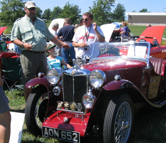

Sebring222 said:This is a "one-off" special. The body was custom made and is not an original MG design. The engine is not pre-war, appears to me to be an XPAG. The pedals are not MG. The wire wheels are not MG, they are some sort of bolt on wheel with fake knock-offs. The transmission is not pre-war, it also appears to be T series, possibly TC. This is an amalgam of parts made up to look like someone's idea of a pre-war MG.

I can attest to this not being an original PB - I used to own one. The engine in this car is, in fact an XPAG (the original engine was a 939cc, single overhead cam engine with the camshaft driven through a set of beveled gears with drive being transmitted through a vertically mounted dynamo at the front of the engine. It had no water pump and no fan, coolant being circulated strictly by thermo-siphon action). The original had clamshell fenders, like the TC, the shift pattern was a mirror image of todays 4 speed shift pattern and the gearbox gates were established by an actual 'H' pattern cutout at the top of the remote, with a manual lockout for reverse gear that had to be flipped up to shift into reverse. As someone else states earlier, there was no syncromesh for any gear, which I soon overcame by learning to shift without even bothering with the clutch except for starting out initially.
