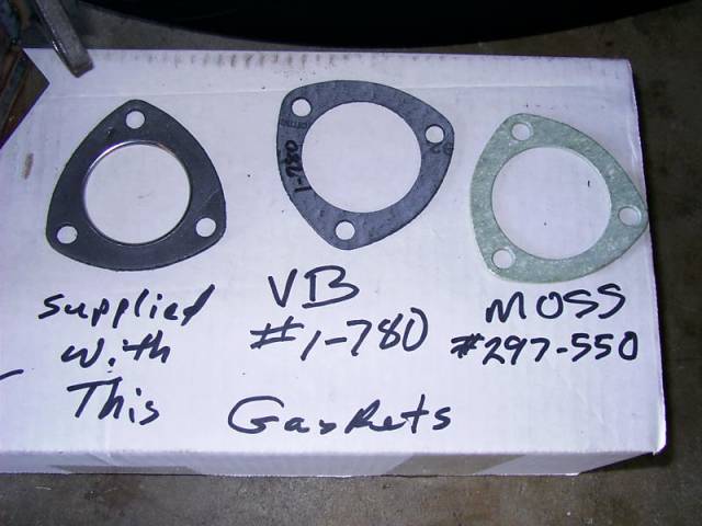

Okay here's the story. The mufflers look fine. The down pipe is connected to the manifold with that #42 piece. That #61 piece somehow worked loose. Right there where the pipe goes into the manifold. Thus the noise and heat (right?) The #42 thingy won't fit back properly on the pipe now, so it's up at the shop (guy's going to 'hammer' it out for us) and it's all getting put back together. Radiator is at the radiator shop now to repair that leak I found yesterday.
So no Peco. ~SNIFF~ But on the upside, should be reasonably cheap to fix and back on the road in a day or so (depending on radiator guy)
Then--onto the speedo. I'm getting a new core first, doing that. I don't want to spend $120 if I don't have to, because that's 2/3 of my carpet kit. So we start with the easy stuff first and go from there. In fact, other than being annoying and the risk of costing me a ticket or two, I can live with that!
RUT ROH!
Guy with the downpipe called. It's fixed. Charge is $40. Dahubby blew a gasket. Said he could buy a whole new pipe for that. So he left with the Moss catalog in hand. ~gulp~

[ QUOTE ]
RUT ROH!
/ubbthreads/images/graemlins/jester.gif
[/ QUOTE ]
Not sure the Moss catalog is going to help with the kind of gasket your husband needs now. /ubbthreads/images/graemlins/smirk.gif
