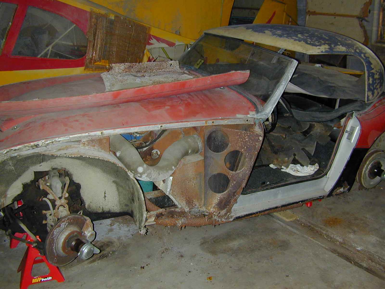

Bythe way, as I was looking at the picture of your car in that musuem, I noticed the cooling air duct does not have a straight line path to the scuttle fitting.I would suggest that you shorten it a bit and remove that floppy curve I see."If the duct is not of the proper type" [Floppy Cloth thing] "replace it with the correct material",its easy to do now that the fender is off.---Da YODA--Keoke- /ubbthreads/images/graemlins/grin.gif

Both the "kink" in the"hose" is WRONG and so is [ QUOTE ]
Made of Poly-Butyl rubber.
[/ QUOTE ]
Cheap, Yep. Correct, NOPE!! Not even CLOSE.
"Kopex" is what it should be. And I stock /ubbthreads/images/graemlins/angel.gif

Not enough air moves through the air hose anyway, so having extra bends will just make matters worse. The straighter the better. Just don't expect to get alot of cold air through it on a hot day. It most likely will be warm to hot, thanks to a hot engine compartment.

I have kept my mouth shut because I have never found a reason to disagree with Keoke, but the path of the air ducting in your car is close to correct. I do not disagree that Keoke may be right about the "straighter path" being more efficient, but if you are going for authentic, the tubes were bent. I have attached an image of my car before restoration began showing the tube's bend. Every other car I have seen that was original or close to it had this bend. However, I am the first to point out that my car is a BT7 so later cars might be different.
