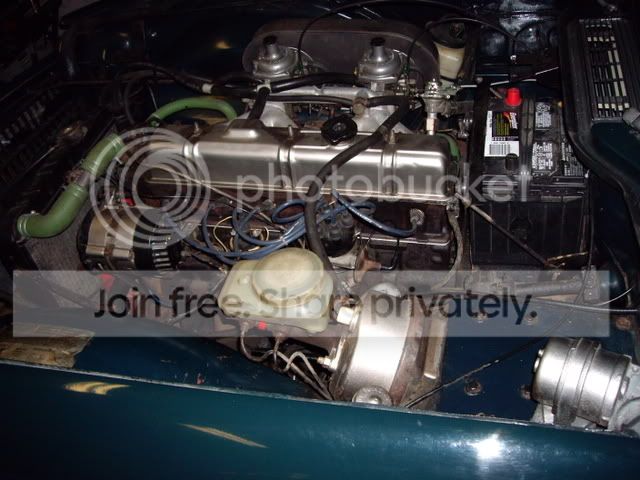

Just test started the TR6 following the installation of my new BPNW TH5 cam and a 100 thou head shave to get to 9.0:1CR.
Have still got to get the cooling system all reinstalled but gave the key a turn and to my astonishment it started.
Messing with that valve timing not to mention pulling and reinstalling the distributor and drive gave me the willies, mostly because it's a pile of work to get that timing cover back off if the valve timing is wrong.
Anyway, not long now and we'll see what these mods do to the performance, the cam alone is supposed to get about 15HP more.

Everything is buttoned up now except I still have to put the "bonnet" back on, a 2 man (or 1man+1woman with a lot of bellyaching) job.
So far I've just had it idling and I certainly notice that it's "lopier" than before because of the cam I guess but it's not bad, just have to have the idle closer to 1000rpm than 850rpm.
Looking forward to geting it onto the street to try it out 'cept I have to give it time for the cam and tappets to acquant themselves.
Graham,
Just out of curiosity, is your camera broken?

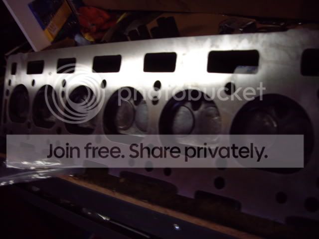

Got to be honest, the only pics I took were the ones as I dismantled and only then for possible reference on valve timing. Had my hands so full of gunk I didn't take any pictures putting it back together, It looks no different after the new power than it did before. The picture of the head is after the 100 thou shave, they did a nice job and checked the valves which only needed lapping.
After seeing what you did with yours I think I'll just keep the bonnet shut and enjoy the new power.:-)
