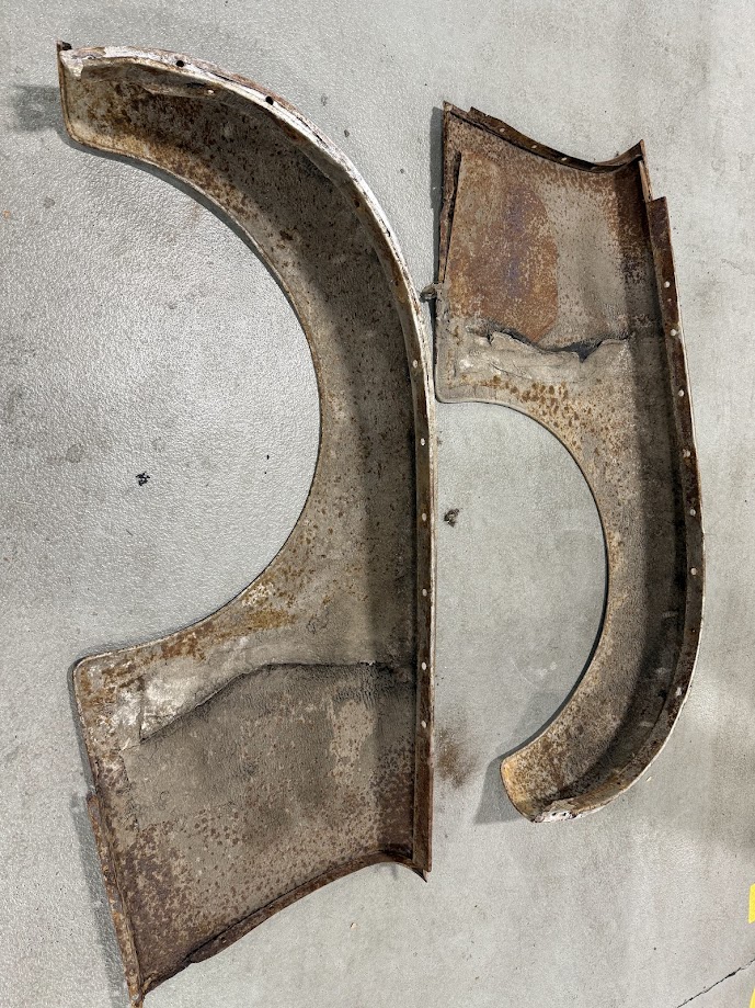

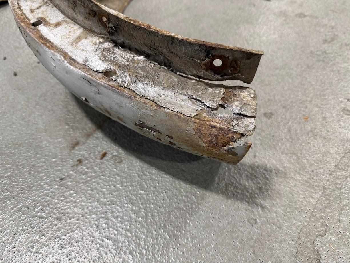

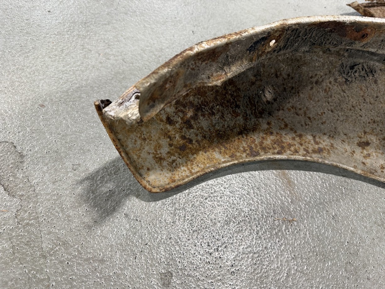

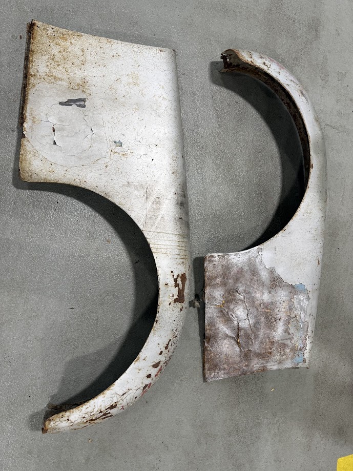

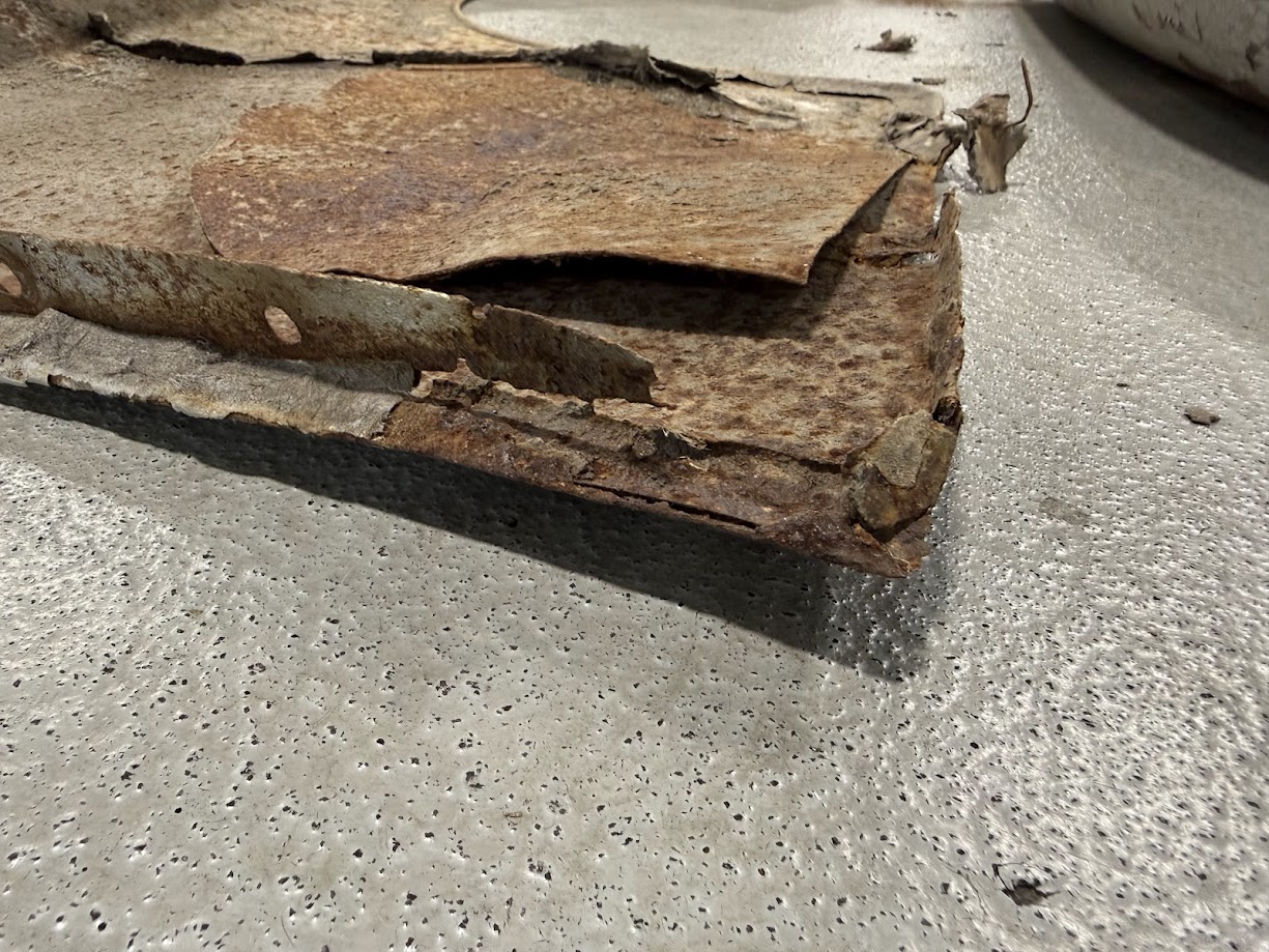

Every panel will need a fair bit of work, both from rot and fender benders/dings/dents/cracks.
Front fenders and bonnet are by far the worst, I think. Fenders will require the mounting flanges to be separated and repaired, then repair the fenders and mount them back together. At least John has the design of the lower flanges where the front fenders mount to the inner sill. Other than that, I'm going to be spending a lot of time forming and welding 20 gauge to get everything looking good.
