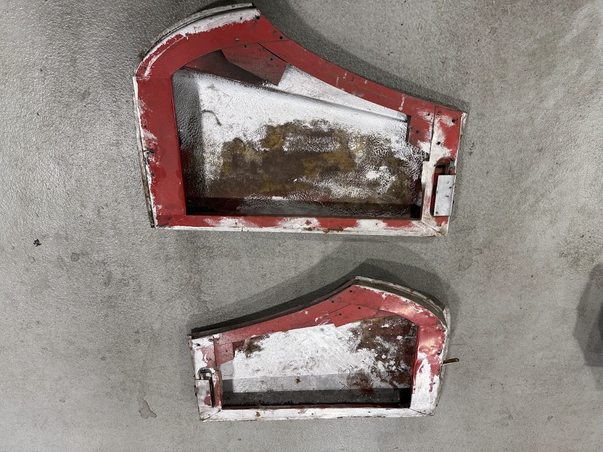

The only things I'm really missing are the wedge mount sidescreens and the grill trim. I'll see if Macy has some sidescreen cores they're willig to sell, and I know they make a repro grill trim piece out of stainless that looks close enough for passing. I don't know if they'll sell that or only fab them up for cars in their shop.
Revington does offer reproduction sidescreen frames if I absolutely need to get them new. Expensive, but I have to have them.

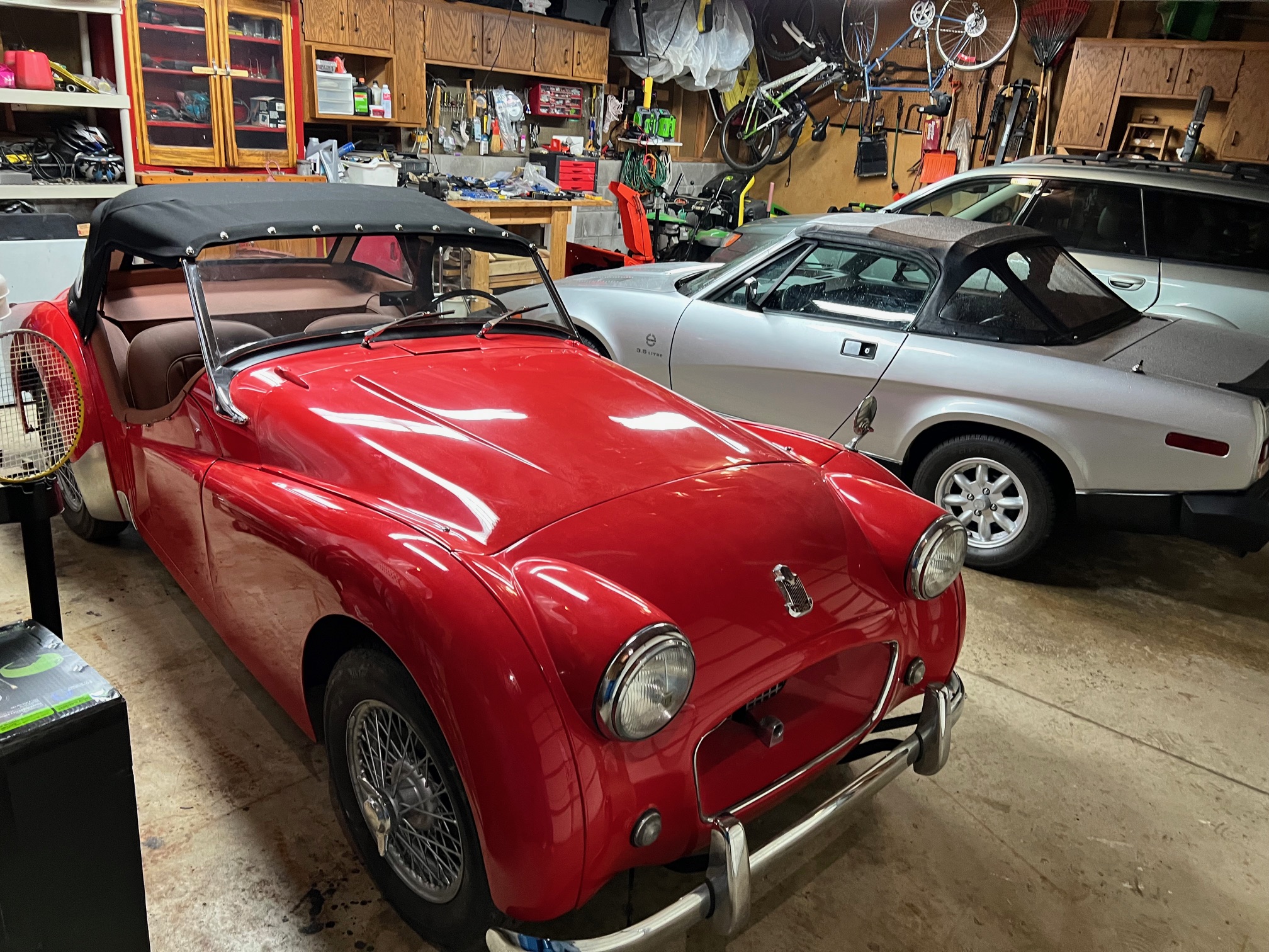

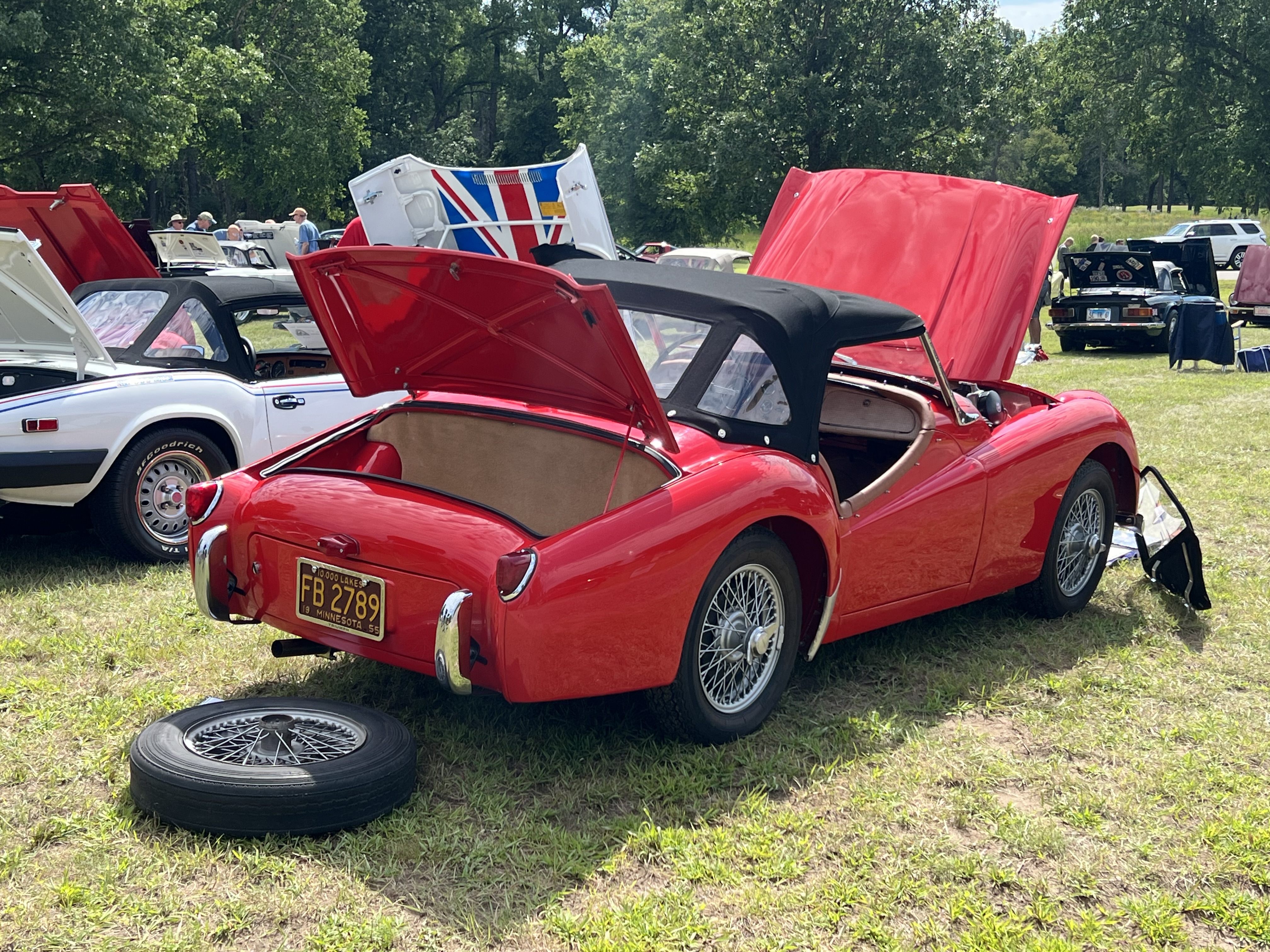

Yes, our cars are not very far apart in number...mine is TS6661L. Interesting your TR2 was assembled in Ireland.
There's a picture of the car on the Ireland TR Register's TR2 page. It's the car with ORI 1 as the registration. You can see some of the car's original red paint peaking through in the pictures.
Ireland TR Register TR2 Page
I wish is was still in that condition now :oops:

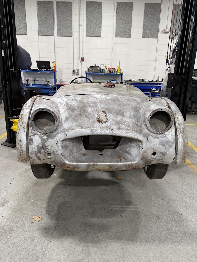

Proceeding apace.
I have nearly everything off of the body except pulling the fuel tank and fishing the wiring harness out of it's various hiding places.
So far I have found no redeeming qualities of this car other than the fact that the dash and gauges seem to be in good condition and the steering gearbox feels surprisingly tight for a sidescreen TR.
Other than that, it's just a opening cans of worms all the way down. Every cage nut is useless and will have to be replaced on every...single...panel. The door hinges unscrewed from the doors, but had to be ground off of the A-Pilar.

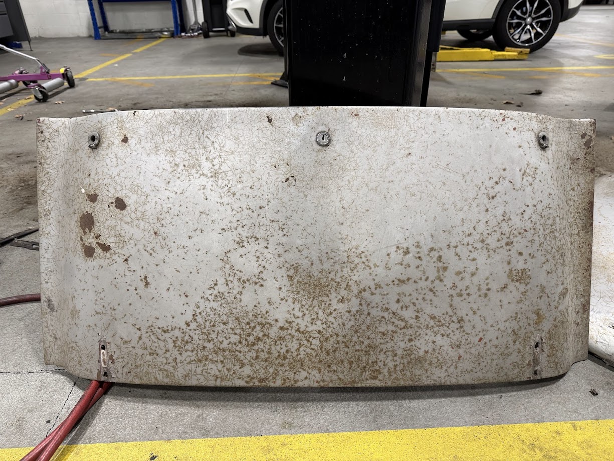

The windscreen mounting plate screws were one solid piece to the nuts on plate behind the scuttle and had to be drilled out. I drilled and tapped the nuts on the backing plate for the 1/4-28 screws that will hold the mounting plate to the scuttle, but I'm not happy with it. I'll end up drilling the spot welds on the scuttle that hold the nut plate and remove the plate to grind off and weld on new nuts.
The sealer plates at the front fender/firewall were completely roached, along with the outer firewall behind it. I may end up having to take both kick panels completely out to make firewall repairs. Which will at least make it easier to repair the aforementioned windscreen mount nut plate on the scuttle. Small consolation.
I'm not discouraged, but overwhelmed. :flush:
I'll feel better when I can start doing some actual repairs instead of just uncovering more disasters.
I'll hopefully be able to grind off all the body mounting bolts and see what kind of disaster the frame is this weekend. There's no way a single one of those bolts is going to turn, so I'm not even going to try. If it's bad AT ALL I'm just going to get a RATCO frame. I'm not dealing with a roached frame for one second.
To make myself feel a little better about the tasks ahead, I've signed up for a 5 day 1-on-1 metalworking class with a coachbuilder to level up my panel beating skills. I'll end up with an entire metal shaping workshop by the time this car is done. It will be maybe 10% original TR2, 80% new metal, and 10% TIG/MIG filler :greedy_dollars:

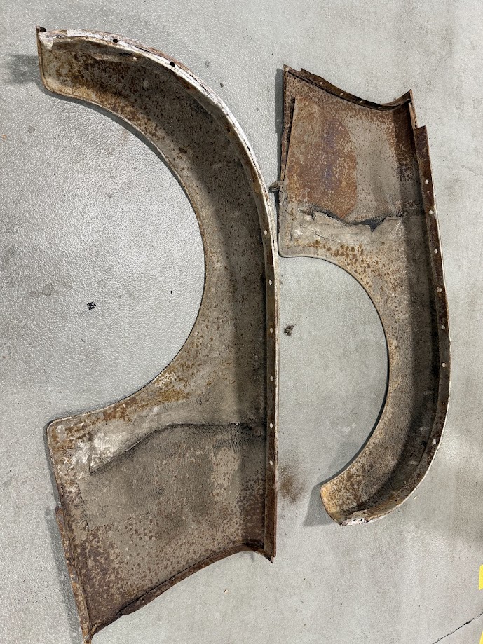

Major points of repairs just to get it stable, from front to back:

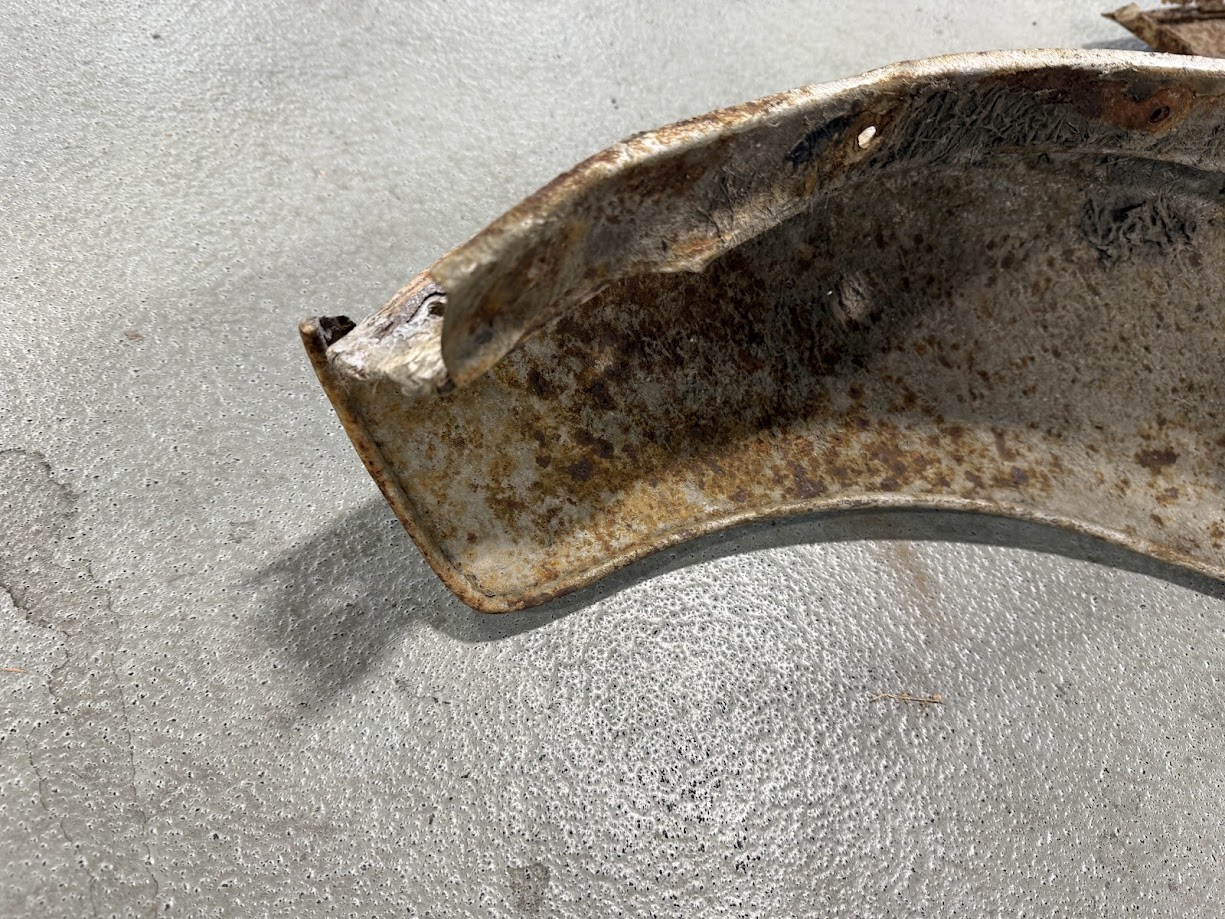

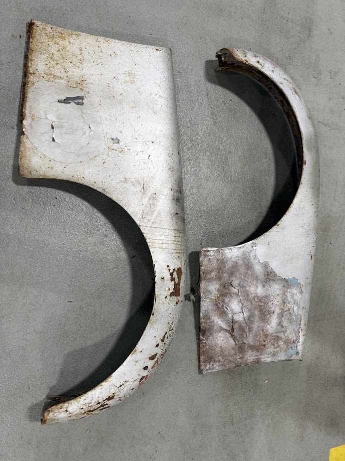

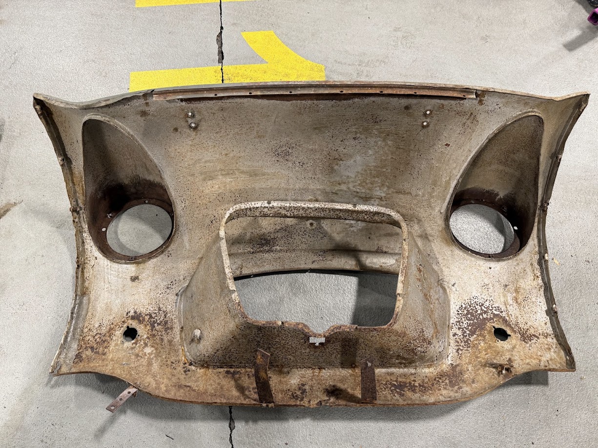

  1. Both inner front wings are rusted/cracked where the front body mount plates back up to the inner wings. This is pretty common on the TRs since water from the wheels runs down the inner wings and down between the body mount and the wing are spot welded together. The right side has also taken a lick at some point and will need a bit of straightening. I'm thinking of making a buck of the front portion off of the better, right, side and simply making new front portions of the inner wings. I haven't decided.
  2. Both inner front wings are cracked at the body mounts where the two bolts hold it to the angled front suspension tower brace. Not a hard repair. Haven't decided if I'll just clean and weld up the cracks or cut out the section and weld in a single thickier piece of steel.

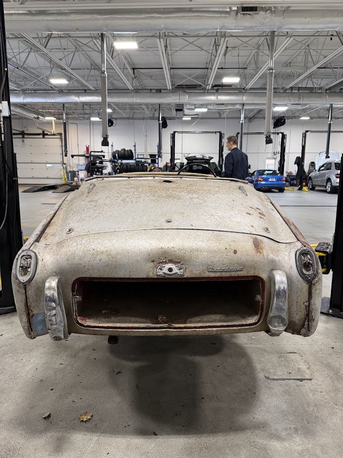

  7. Inner and outer sills, floors, and the lower aboutn 3-4" of the firewall and kick panel are toast. The inner sills aren't that bad, but they'll still go since the far forward and rear portions have some rot and those are areas the fender mount.

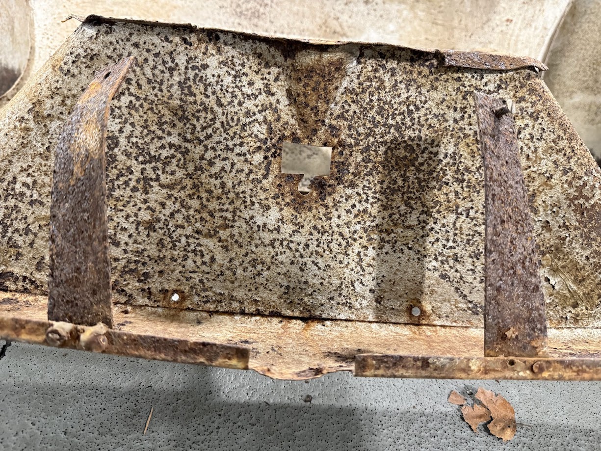

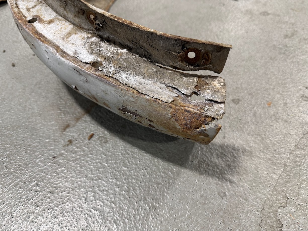

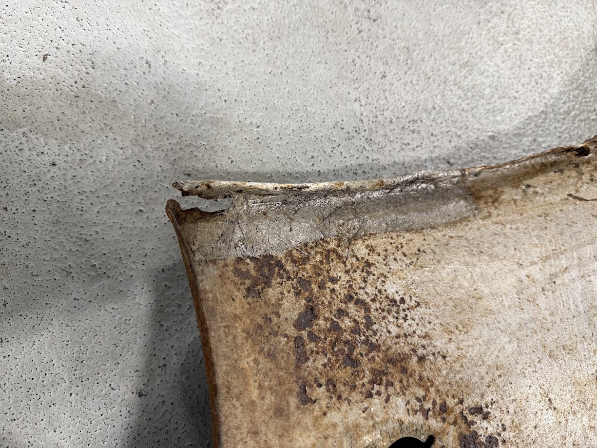

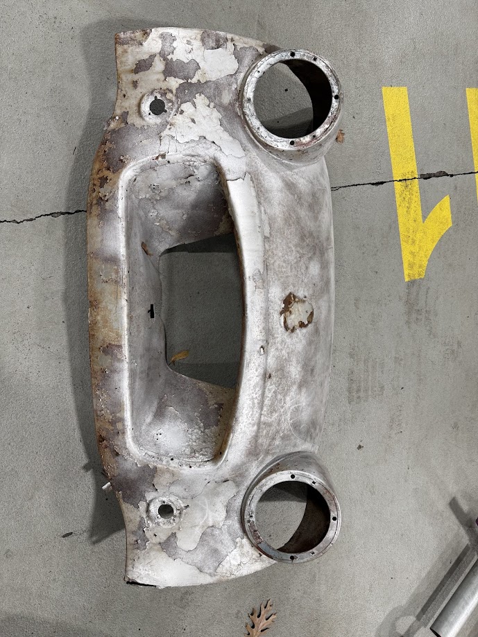

  8. The closing panels for the rear valence are shot. Completely. They were all coming out for repairs to the rear valence anyway, but I don't think any of them are salvagable enough to go back in. The valence is in pretty good shape other than some dents and dings. Even the lower flange where it rolls under the bottom closing panel is OK. It looks like all the closing panels took the rust hit.
  9. The rear valence itself has taken a few bumbs over the years and will require a good bit of hammer and dolly work, and some repairs around the bumper distance tube areas. These are bent and cracked from the bumpers taking hits over the years. I'll put in the new kits that replace the tubes with solid SS distance pieces. I don't plan on running bumber on this car since THIS is the exact build I'm looking to pull of on this car. But I'll keep the options to run bumper and the solid SS distance tube will remove the chance of water getting back in there through that area ever again.
  10. The seam where the rear valence and the tire well are spot welded together has been hit and split open in a few placed. No rust, just poped spot welds. I'll treat this area for any surface rust and get the flanges straigh and plug weld them back together.
