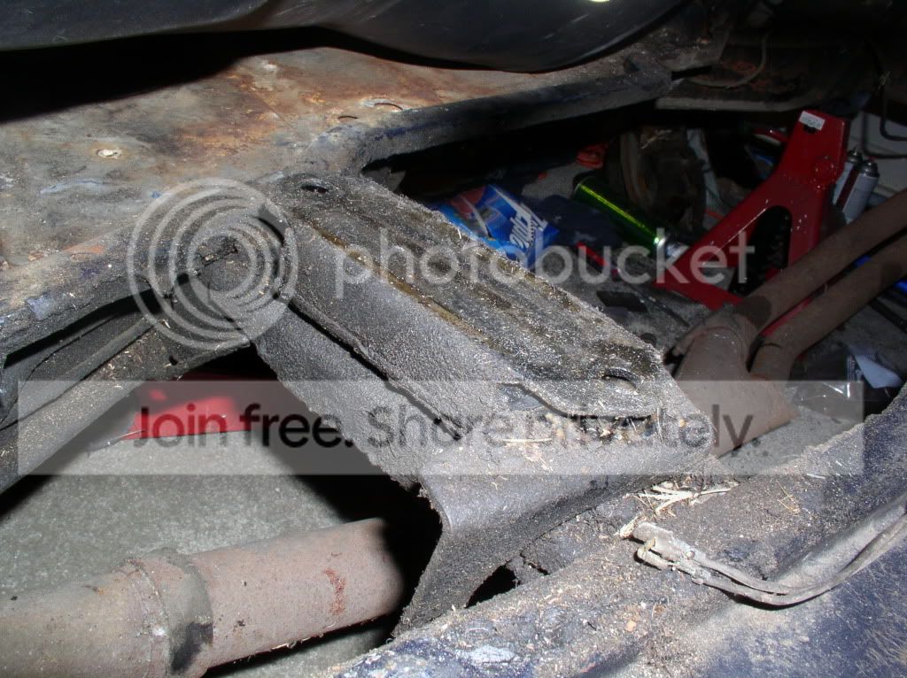

Hi guys - I've never convered a standard gearbox to an A-type O/D unit. Is this original transmission mount OK to use with an A-type gearbox?
The mount type is fine.
But don't you want to replace it while you're in there? It's aggravating to have them break ...

I agree, same mount but $15 or so replace it. One of only 3 points engine and gearbox are fixed. When it goes makes awful shake in car and is probably the reason u joints went bad. Good thing is shake went away, little did I know.
Ditto on what they said. I changed mine out last year, and when I did I was shocked to find that the mount was completely gone - all the rubber had perished and it was only the metal framing that kept the top and bottom together. Car didn't shake when driving but I'm sure there was a lot of movement at times.
Oh, yeah I was going to replace it as a matter of course. I just wasn't sure of if was correct for the A-type O/D.
