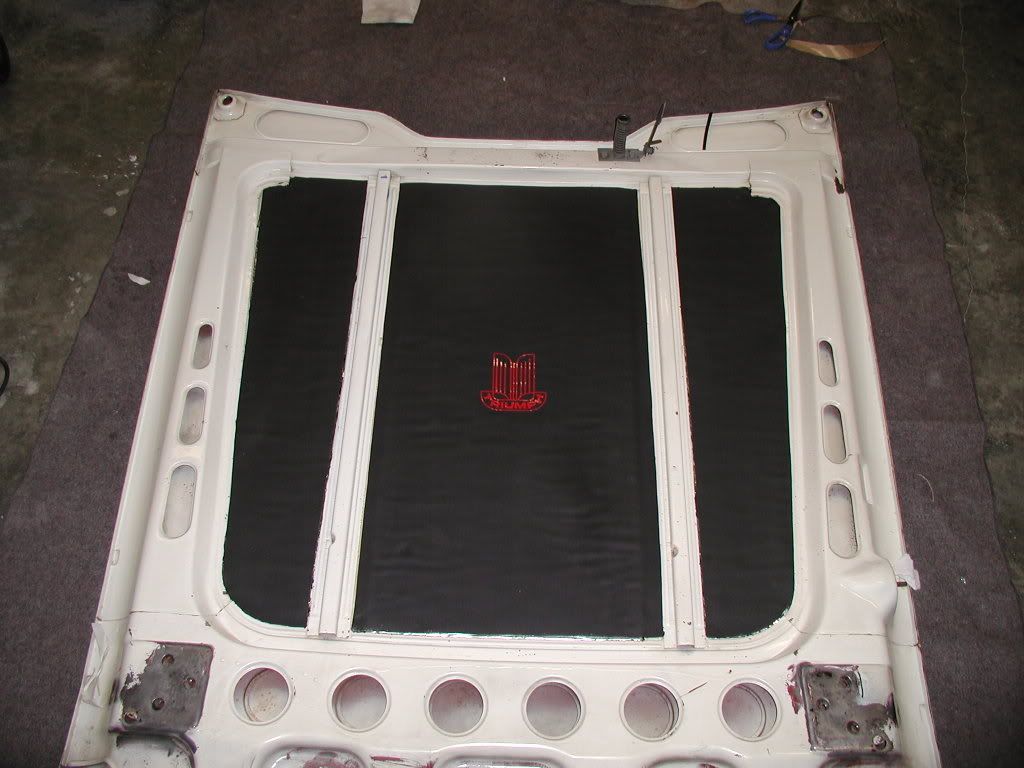

Here are some photo's.
I covered the interior side of the firewall and the battery shelf. I did the inside of the doors, the gearbox tunnel and the rear shelf and wheel wells. I also did the trunk lid and the trunk sidewalls and wheel well arches and trunk floor.
I also did the engine hood and added the foam lining over it.
I used a product called RAAMMat. https://www.raamaudio.com/
It is similar to dynamat. I also used the thin foam sheet over the firewall area's.
