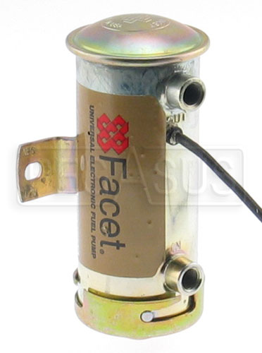

Any thoughts. I'm thinking about switching fuel pumps to the electric solid state one that Moss sells. I bet this one I have now doesn't have 2000 miles on it. Thanks! Kurt
