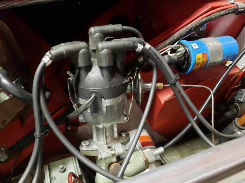

My BJ8 has the ‘standard’ basic coil and I wonder if anyone has used either the Intermotor or Lucas Sport coil. If so, do they give any noticeable improvement of any kind?

If you have the standard coil that came with your car, it is likely more reliable than the modern replacements, which have had quality problems.
I'll second that. My BJ8, with about 210K miles, is still running its original coil (with a dent in it, even). AFAIK, an 'uprated' coil capable of producing a hotter spark--with a larger plug gap--would only be beneficial in a highly-modded engine with compression over the nominal 9.1:1, and you'd need to upgrade the entire ignition system to prevent cross-firing.
Sorry, I neglected to mention that my ignition system is the Petronix Ignitor 1, which uses solid core wires. I’ve been running solid core wires with this system for about 8 years now.
steve
Bob, I have a positive ground car so Petronix II is not an option unless I change to negative ground. What are the benefits of the II ?
