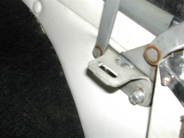

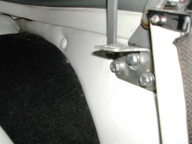

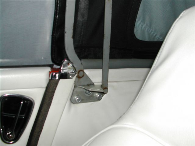

good advice all - thanks. anyone got time to pop a picture of the bracket where the top frame attaches.
thanks all

Do you want a picture of the "hood" (convertible top) bracket that bolts behind the seat (3 bolts per side) ? I can take a picture of my car tonight for ya, just want to be sure that's what your looking for :-)
exactly that - thanks
Goodmorning JP
Hopefully this helps, let me know - btw thanks alot I still have 2 feet of snow in my front yard but you go and make me look at Midge and make me even more anxious for the snow to be gone ! :-)

Thanks - exactly what I need - I had forgotten you have a white interior - amazing. our snow is almost gone - hurray!!!!
