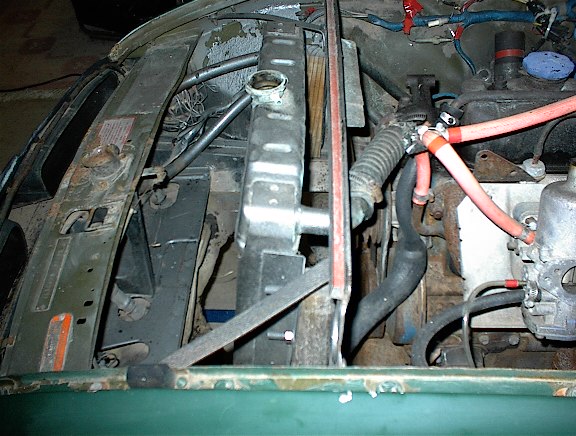

There appears to be some other DPO's in that photo...look at the radiator duct panel...there should be a fiberboard lower air duct panel between it & the radiator...
& I hope you knew Doc was funnin'...yes, there was a tiny spacer between the radiator & its support - about 1/8" piece of fiber that had 3 holes in it to fit over the 3 bolts holding the radator to its support panel.Methinks somebody was concerned about the fan hitting the rad so moved the rad forward.
Is the "snoot" on the later waterpumps longer? IOW (In Other Words): is it possible a DPO put the wrong (newer) WP on the engine, then "extended" the clearance with those GIANT toothpicks?
Early water pumps were longer than later ones, but they are not interchangable without significant modification. I'm thinking someone either wanted to fit a bigger, incorrect fan or didn't know anything about how fans work.
Thanks for the infor. It looks as if everything would clear the radiator if it was returned to original spec. As for the bonnet, there is a large dent in front but apparently that was a result of a previous owner backing another car into it. Still, the car came with a brand new replacement bonnet so I am good there.
