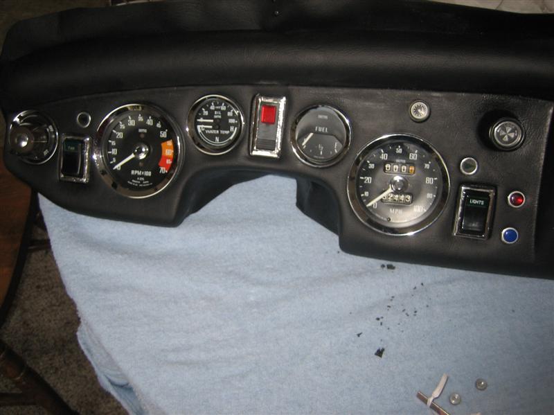

Anyway I am getting the dash together using Weldwood. I found that the plastic cover needed to be cleaned with rubbing alcohol before applying the cement. I am not rushing things too much and should be finished by thee time the rest of the bits for the interior arrive.

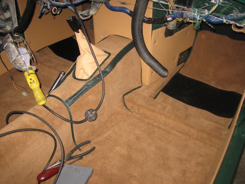

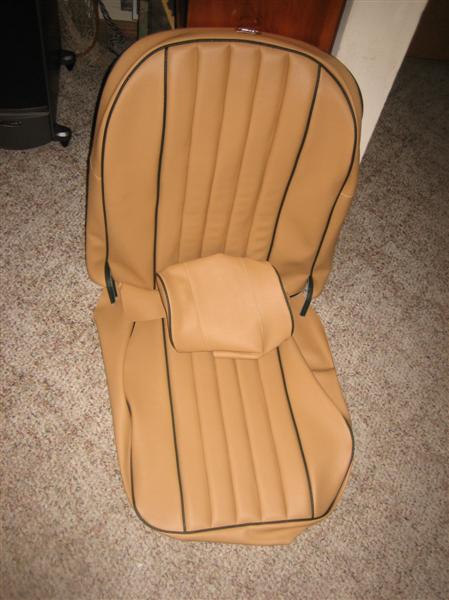

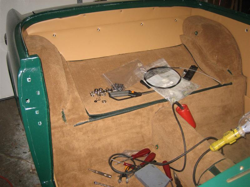

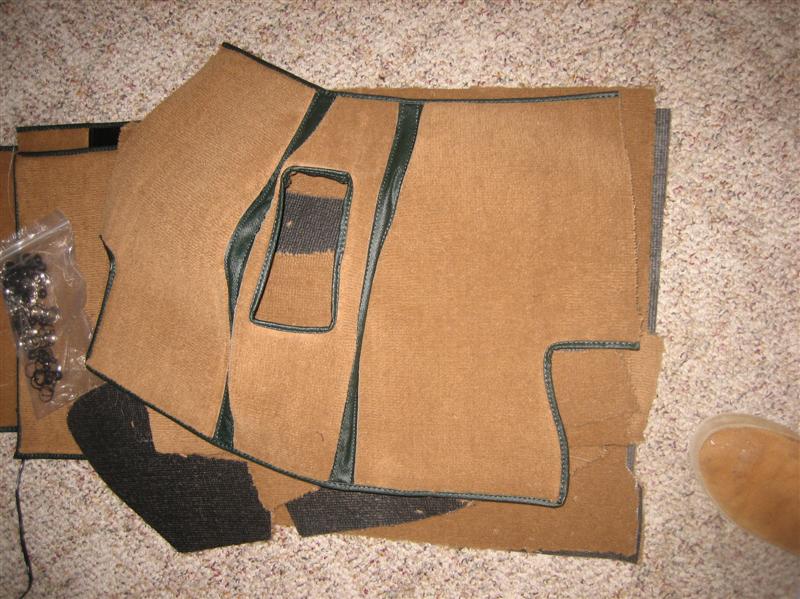

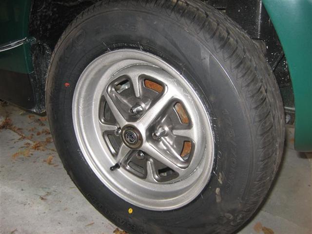

Last week I painted the wheels and this morning i had new 175/70R13 tires installed. And the seat covers and carpet arrived from Prestige. I think they look great.

Looks great - I particularly like the grey in the wheels - I used grey as well instead of black and think it updates it subtly and makes it look much nicer!
Tom,
I really like your choices and can't wait to see it on the car!
