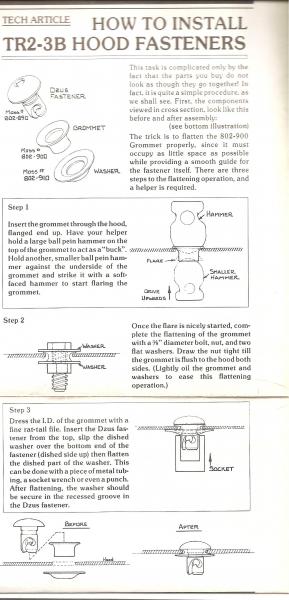

Here is a tech tip from an old Moss newsletter (1984) describing the installation of the dzus fasteners. I don't like using a hammer to start the flare and made a cone for use with the bolt.

It’s there, Post #118! No hammer involved!
Go to page 6 then scroll down to post 118. There is a lot of stuff there before you get to the Dzus fastners.
