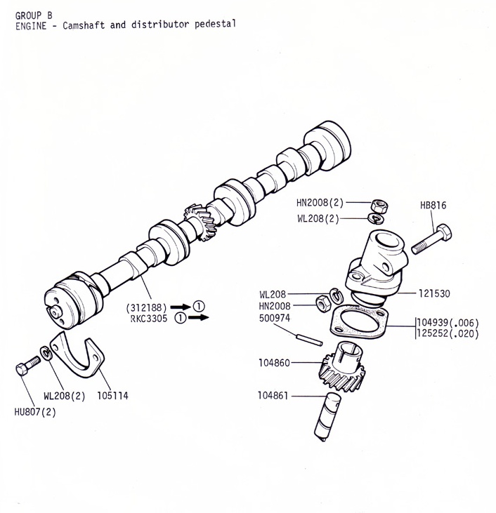

There are several ways you can deal with the problem. Probably the best is to remove the distributor pedestal (121530 below) and "re-clock" the drive gear (104860).
Two choices:
#1 put it in the way it fits and move the spark plug wires 180 degrees.
#2 pull the drive gear out (104860 above) and put it back in 180 degrees from where it was.
Either way it should work fine.

I vote #2. Sure, #1 is quicker, but it's going to drive someone crazy in the future! :wall:
