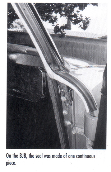

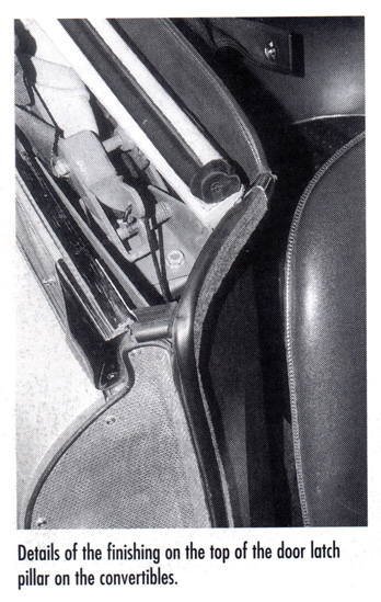

I recently ordered the “Bristleflex” from McGregor’s along with the bits and pieces for installation. The Anderson/Moment (2000) book states on page 171 that “At the top of the rear door pillar the seal runs along the top of the inner rear-quarter trim panel about 4 inches, covered at the end by a zinc-plated ½ wide clip.” The attachment is from the B.M.C. Service Limited Mechanical Service Parts List for series BJ7 & BJ8 that illustrate items #10 & #11, rubber caps, at the end of the fuzzy seal. Is this correct? If so, does the zinc clip go over the rubber cap or is it fitted next to the cap? Where does item #9 (a screw) go? If anyone can offer any installation tips or post a picture of the top of the rear door pillar showing how the seal ends (with/without rubber caps, placement of the zinc clip, etc.), I would appreciate it. Many thanks in advance for any help.
