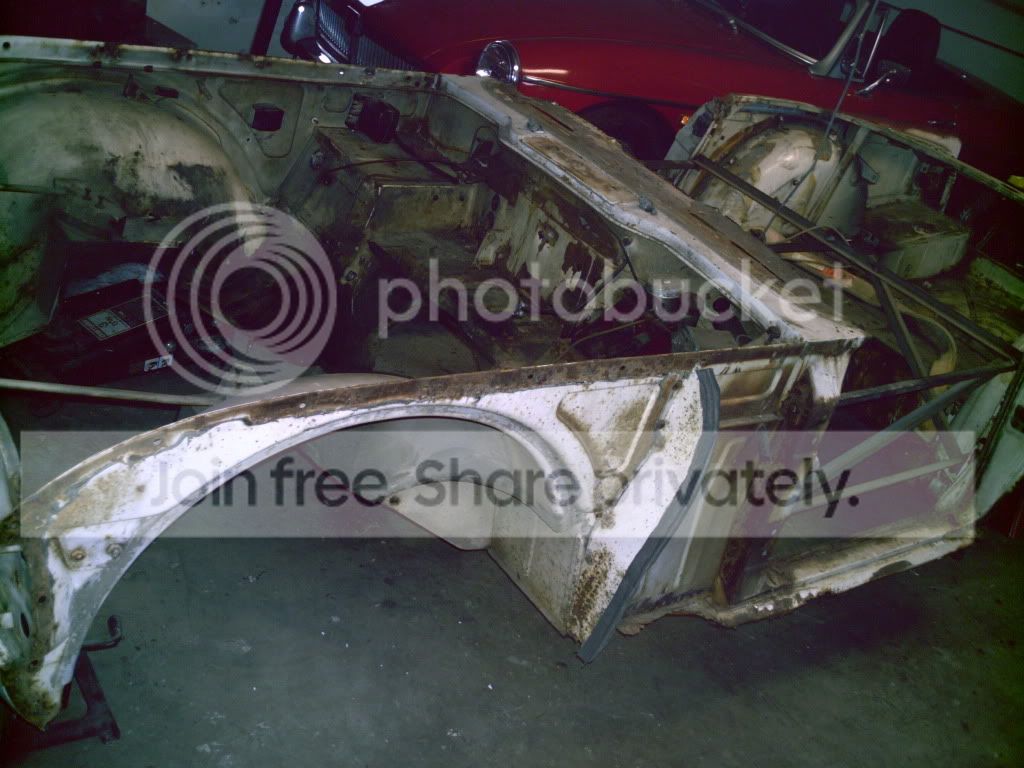

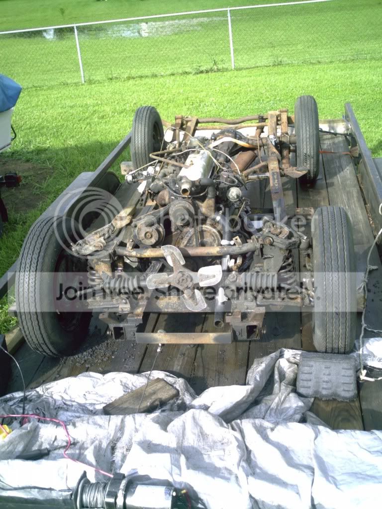

First I pulled the body off the frame. No holes in the frame, other than the rear crossmember.
Can't say the same about the tub...
Note my friend's MGB in the background. Just finished reawakening it after a twenty year nap. All it needs is new tires and tags, and it's ready to roll.

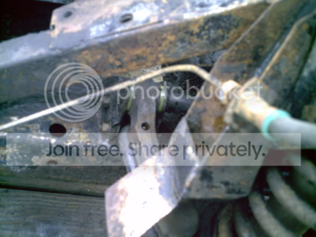

Somebody already replaced the lower arm bushings maybe? Woo Hoo!

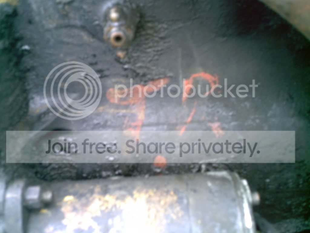

Original painted on side of engine block?

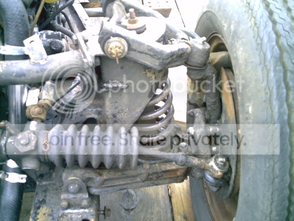

How is a Triumph front suspension like an English muffin? Lots of nooks and crannies! Two rounds with the power washer and it's still filthy.
Looks pretty solid to me. Remember what old Confuciusy baby say, "A journey of a thousand miles begins with a single step."

And, yes, that red-orange "TR3" was applied at the factory. Blocks were built for several different models, and it was their high-tech way of separating them. When I rebuilt the engine for the '57 I had, I painted the block, then applied the "TR3" where it had been.

Mickey Richaud said:
Now the fun REALLY begins!
But his is a TR4. Leftover TR3 engine? Or swapped sometime during the car's lifetime.
Did they still paint TR on 4s?
It might be a number 4 written behind the starter. I haven't cleaned it off enough yet to tell.
Also, this is CT471L, one of the first ones to roll off the line. It has lots of TR3 style parts on it. The engine number is very close to the commission number, so I am pretty sure it's the original.
This frame has to have the hardest, nastiest grime on it I have ever encountered. Oh well, it appears to have protected the frame and suspension components well!

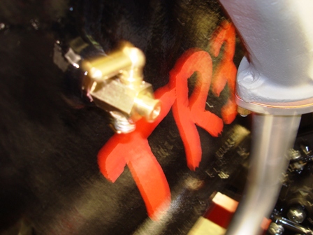

Mickey - that's what we did too. This one is slightly different, but we took photos of the original faint remnants on the block and then duplicated it as close to the original as possible.
