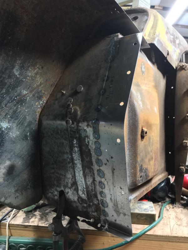

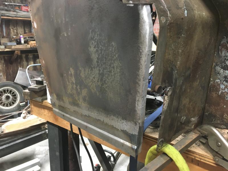

IMG_0060.jpgthis is the original battery box as I was drilling out the spot welds to remove it.
IMG_0135.jpgPieces parts of the new battery box, copied from the original.
IMG_0002.jpgBox spot welded together no bottom yet.
IMG_0813.jpgbottom with dimpled drain hole. I got lucky to find a drawing in the service manual with the drain location since I did not have a bottom to copy.
IMG_0812.jpgbottom with drain. I did take a liberty and used a hose barb for the drain. The hose barb is still the correct diameter as the original drain tube. Once the bottom was spot welded in I ended up with a little oil canning so minor heat shrinking took care of that.
IMG_0811.jpgfinished battery box ready to install. Tush was very helpful in letting me know about having to cut the fire wall to get the top flange under the scuttle. That will come down the road, for now it is out of the way. This was a fun project and looking back has helped me see that there are a lot of parts that have already been repaired and are ready to be added to the puzzle when the time comes.
The last photo is of the back with mounting brackets.

Nice work Frank I forgot you fabricate so well. If you go with an OD, the relay bolts to the back of the box. I drilled mine out after the box was in, so no biggie. The holes get counter sunk; I guess so the battery does not get poked with the screws. I copied how John did it by pulling a bevel headed screw back with a socket for a spacer to make the depression.
Nice...your box deserves the BH stamp of approval! I’m jealous you have a spot welder too.
That is a great looking battery box. Probable much better than the one that came with the car from Triumph. I did add the plastic insert to protect the paint.

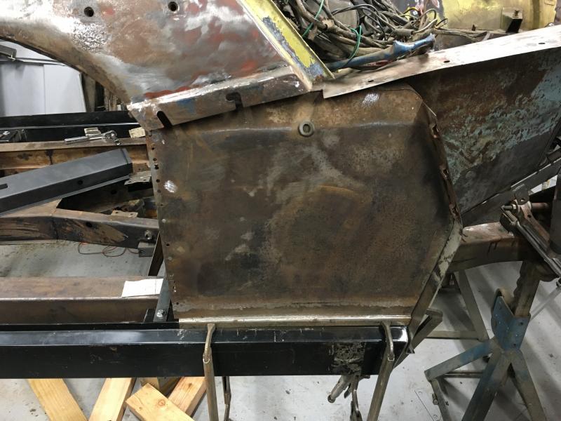

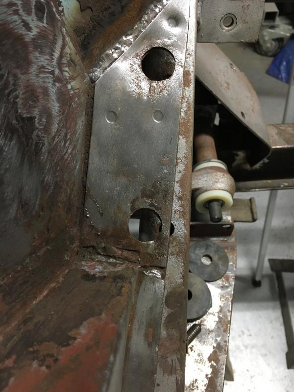

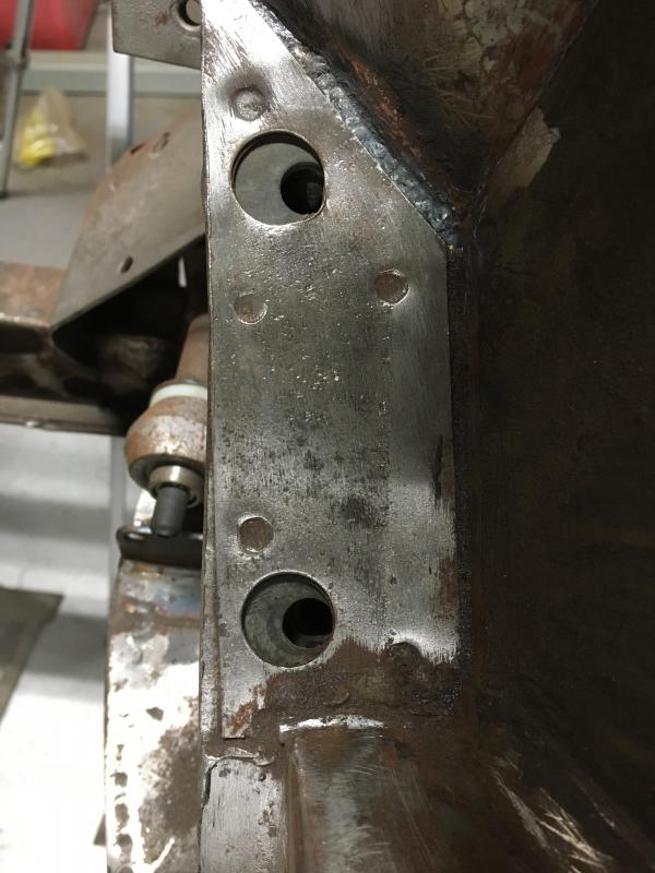

IMG_0816.jpg This is on the driver side of the front clip at the tab where the slave cylinder is on the transmission. The flange has a radius in it and appears to be factory but not sure and not sure the purpose unless something passes under the flange. Did not want to change anything till I know how it should be.

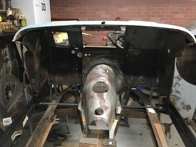

IMG_0817.jpg This is the passenger side of the transmission tunnel. What is the purpose of the mouse hole. It is possible this was an over drive tunnel but I am not sure. It has the hole for the earlier transmission with the dipstick. It also has the hole on the driver side to check the oil level. It also had an extra large hole on top towards the front that did not line up with anything. I believe this car has had many alterations during its life. Frank

The hole in the first pic is where the clutch hard line attaches to the clutch flexible hose.
In the second pic, yes, the lower hole is where the OD speedo cable comes out. The tunnels were not different between the OD and non OD cars, and the hole gets covered with the seal for the handbrake later. The hole on the left was also used as an exit grommet location for the OD wiring. The early tunnels did not have a hole for the oil fill, as it had not been moved to the left side yet, and filling was through the dipstick hole. I would have to see the hole up front center. The only one that comes to mind is the battery box drain, but that is only 1/2".
You probably know the large center hole is for the shifter, and the one to the rear is access for greasing the U-joint, which is inaccessible from the bottom of the car because of the cruciform box on the frame.
So it sounds like your tunnel is normal for an early car, before the dipstick was removed from the tranny.
I think the bracket should be twisted so the hole faces down to the clutch slave cylinder.
Graham
Thank you Graham, When I repaired the frame I seem to remember that the tab was pretty mangled so I straightened it. Now that I know how it goes that will be an easy fix.
Thank you John for the transmission tunnel explanation. The large hole on top was cut by the PO and does not line up with anything on my transmissions. It had a home made cover screwed over it.
My question about the first photo was not very clear. This is my first attempt at editing a photo that might help.
IMG_0816 (1).jpg does the curved flange look right? It appears to be original but not sure.
The holes on top of the shifting tunnel might line up with the OD cut out switches. Good idea probably for access.
I have some photos of the area you are looking at but they are not very clear but may be of some use.
Graham
I just had a look at that bracket and the shape of the inner fender at the bottom where your arrow is is flat the same as my photo above on the other side. The bracket has some raised bits to improve rigidity.
Graham
