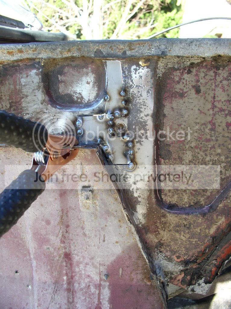

Still learning here, and these welds need to be ground down still, but starting to come together. The metal here is really thin, and it can be hard not to blow holes in it.

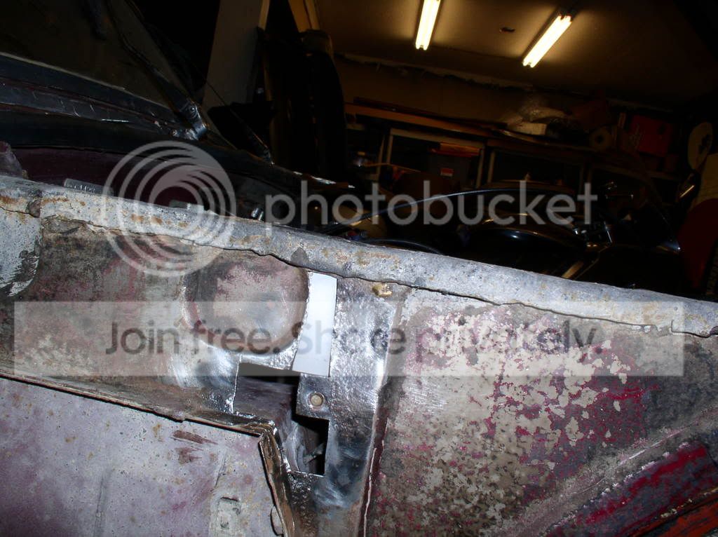

Initial test fitting of the patch panels;

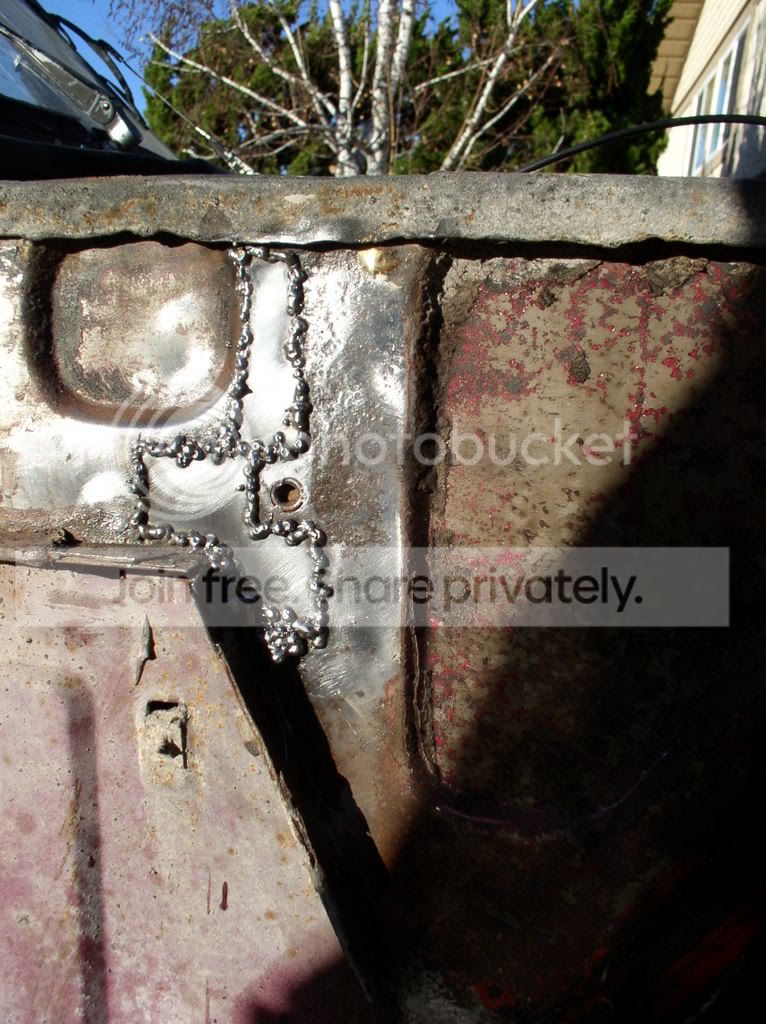

Some tack welds to hold the panel in place;

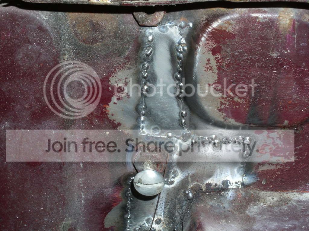

These welds are a bit "bulky" but will probably grind down OK. I usually have some touch up to do after the first pass at grinding the welds down, and tend to over compensate by putting more new metal in than is ideal.
The only view that <span style="font-weight: bold"><span style="font-style: italic">really</span></span> counts is looking at the inner fender from the engine bay. The outside fenders will hide the ugly welds where I had to build up some metal. I was trying to balance getting acceptable weld penetration with not distorting the metal and trying to minimize the need for any filler.
As you can see I still have some work to do...
