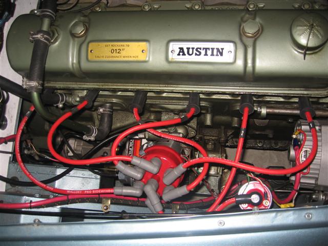

Picture of the Mallory Unilite, ballast coil and new wires attached. It IS red!

[ QUOTE ]
It IS red!
[/ QUOTE ]
It sure is. Good thing you have the same on your red car. Color coordinated? Guess I could paint my black cap.
