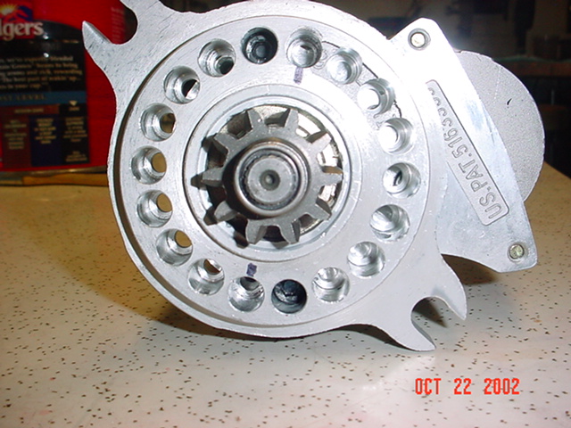

4- I personally would use the gear reduction starter from APT. It draws much less current & cranks much faster. I suggest APT because it has many starter to nose indexing options which may be needed to get the starter to easily fit in the intended space.

where can I find a the APT Starter?
M
Try here:
https://www.aptfast.com/
Not cheap but a vast improvement.
Pic attached.
I had my original starter rebuilt by a "very reputable" rebuilder. It lasted about two years. The GRS only draws about 1/2 as much current also.

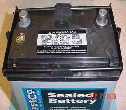

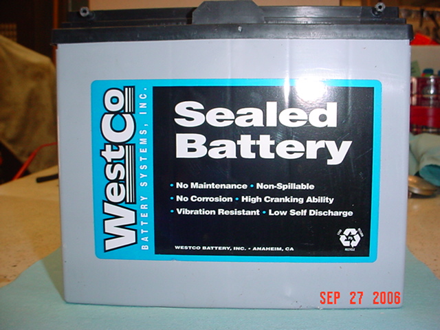

I've been getting by very nicely for the last year or so with a very small WESTCO 12V31M sealed battery which was OEM on the Miatas. 33 AH capacity, weighs 24 lb. Pic attached.

dave, im buying the gear reduction starter and replacing the battery in my bj7, i just now searched the "westco" batt. 12v31m they list it as being 7.5" long ans 5" wide, did i miss something here? is this the one your using in a motor bike or lawn mower? sounds kinda small, cant think of how ill use all that extra room in the boot. /bcforum/images/%%GRAEMLIN_URL%%/savewave.gif
Hi Anthony,
That's the battery. Small but powerful. It's rated at 475 CCA. It wouldn't crank for ten minutes at zero degrees but will certainly handle anything that starts reasonably quickly. The engine is a 2.7 liter four with 9.8 to 1 compression.
The attached pic shows the 1/4" diameter rods with end plates that I made for a hold down.
D
It's a group 12V31M. It is a AGM type. no electrolyte to spill. Built to replace the original Panasonic battery for Miata. Dimensions are, 7.5 long, 5 wide, 7.25 high.
It fits very easily in the RH side of my BN2.
Quote from my earlier post:
"I've been getting by very nicely for the last year or so with a very small WESTCO 12V31M sealed battery which was OEM on the Miatas. 33 AH capacity, weighs 25 lb."
