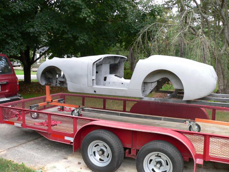

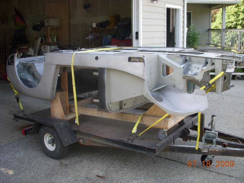

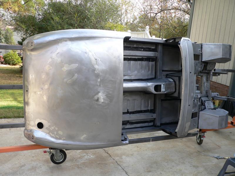

Sand comes in all types of grits. After running a few test with glass bead, medium grit, we ended up using fine grain sand, no heat or distortion in sheet metal which is what you’re looking for. I was very satisfied and was only charged $300. The bad news with using sand blasting is the clean up inside the car. Its best to have the car on a rotisserie let the gravity help in getting it out.
When sand blasting, you need to knock the peaks downs a little with 180 grit, this works very nicely to lay your epoxy down on.
