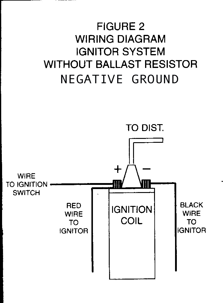

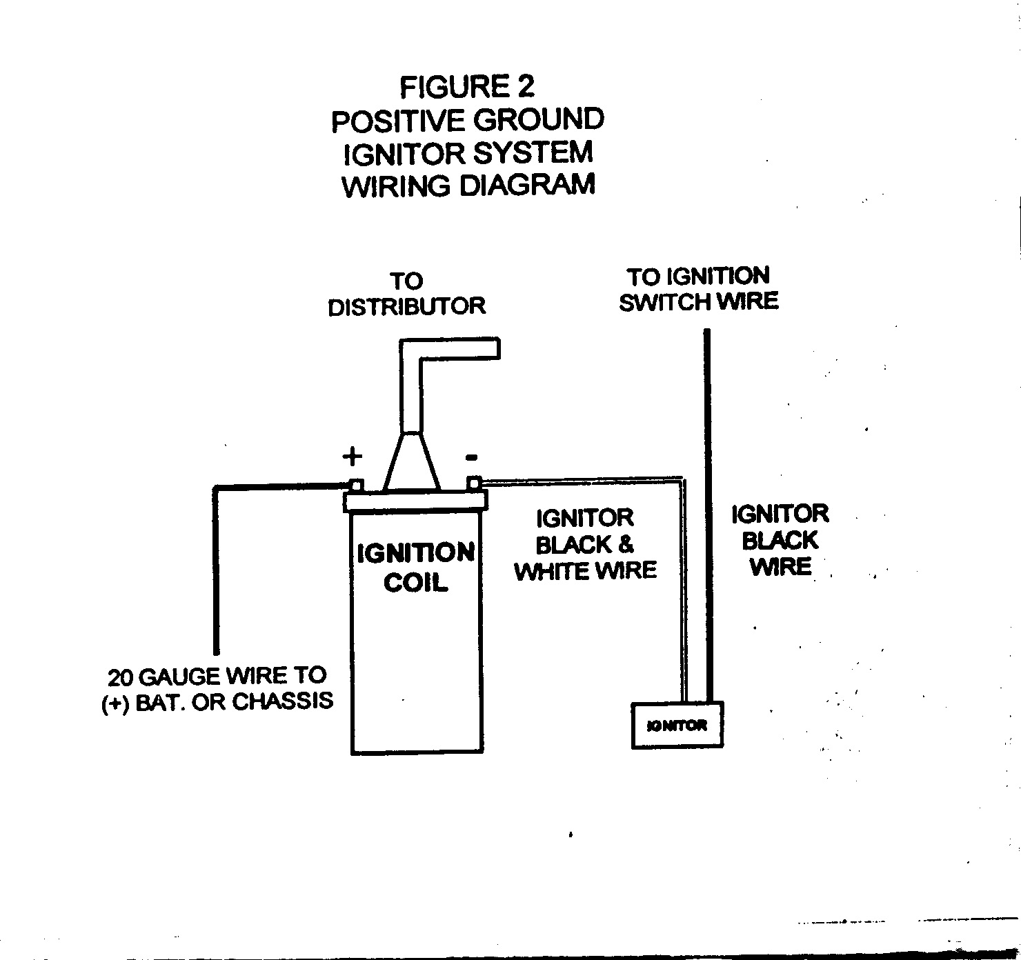

Recently converted my pos grd 61 sprite with generator to neg grd with alternator. I followed the alternator conversion kit directions and car started right up. Now, I've installed an ignitor (neg grd version) and car won't start. The alternator conversion kit required that the white wire from harness (ig switch) go to the neg terminal of coil, but the ignitor directions require opposite. I've tried the wires to coil both ways, and not starting. My question: should the white wire from harness and the red wire from ignitor go to the pos terminal of the coil as ignitor directions state? Or put another way, is the ignitor for neg grd cars just for neg grd cars not previously pos grd cars? Or, could the ignition timing be too advanced? ....irish
