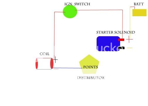

I made a diagram of how everything is connected at the moment.
Make sure the stack up of the ignition wires and the plastic bushings is correct on the points. The wires should be inside the bushings against the spring that attaches to the movable point contact. If it is not you will have a direct short to ground.

I've been tracking down the wiring around the car and all looks to be correct. The guess I can come up with is even after carefully putting the points on, I managed to get a short from inside the dizzy because of my lack of experience with assembling points. :p
I must have missed it but you did put a condencer back in. Won't run without it.
