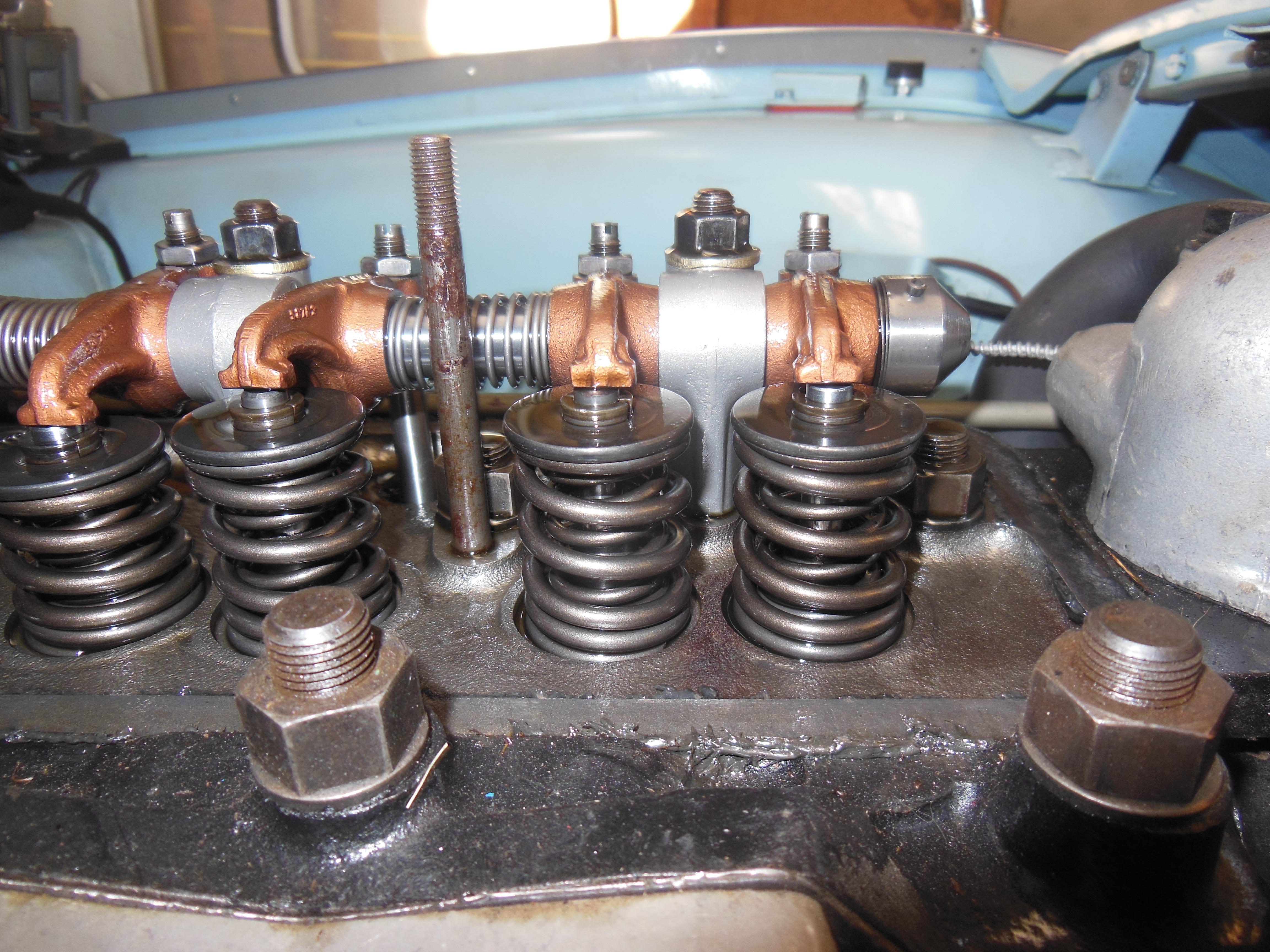

I went and already took the valve cover off and put the crank on TDC because I had the plugs out and wanted to the valves. Cylinder number one looks like both valves are closed. My thoughts were there are a lot of little teeth moving on those gears and maybe if one tooth is off that would explain some of the problems I have had with this engine. The engine carbons up the pugs too quickly. I have been chasing fuel and timing to clear up the carbon, but nothing seemed to work.
I put 3 pints of canned 92 octane from HD on top of a quarter tank of fuel. Now that the valves look ok visually I will put the plugs back in and try and start it. I also took some fine paper to the points for good measure.

I advanced the timing a few clicks on the dizzy and got the car running strong with an idle of 800. It pinged a little when I tried pulling a small hill in second. I am convinced the valve timing is correct by the way the car accelerate and idled plus the fuel ratio sounds correct. The higher octane fuel probably help a lot with that also. When the engine pings, I am supposed to retard the timing a little, right!

Yes, if it is pinging, the retard the timing a bit at a time until it goes away. I agree with you that the cam timing is correct. Otherwise it would run poorly at low speed, or fail to rev fully on the high side. I think once you burn through this tank and refill it will start and run fine.

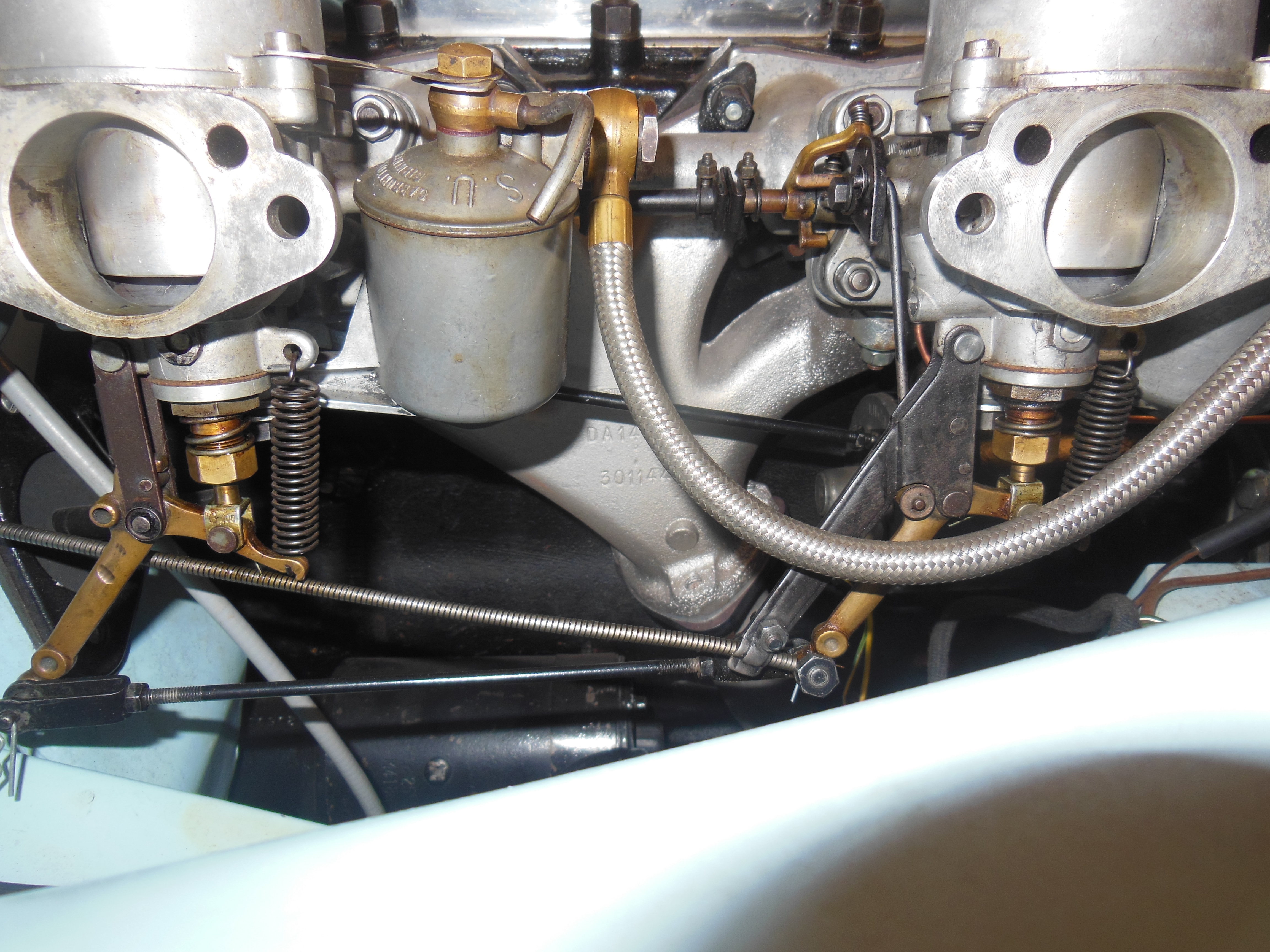

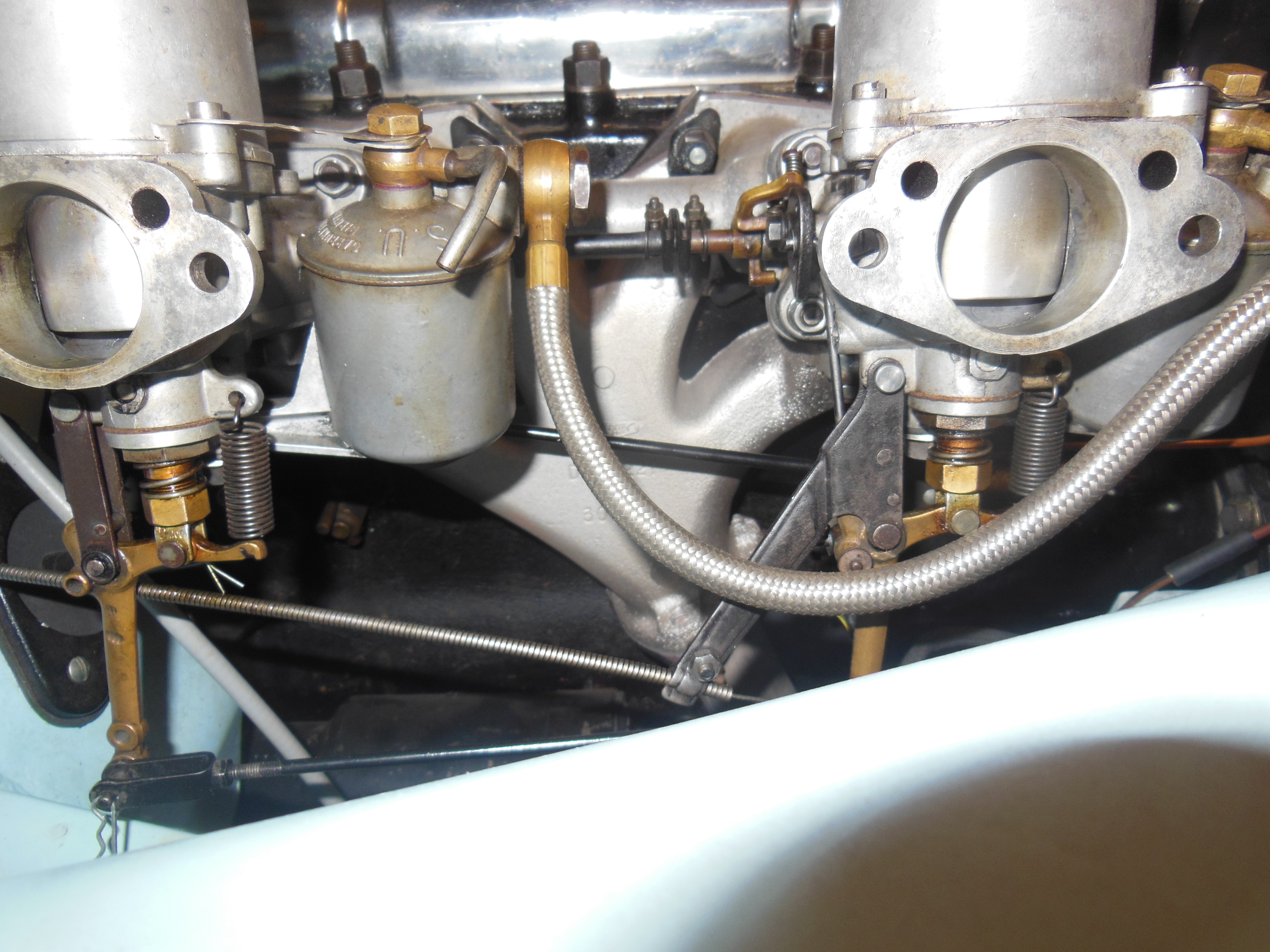

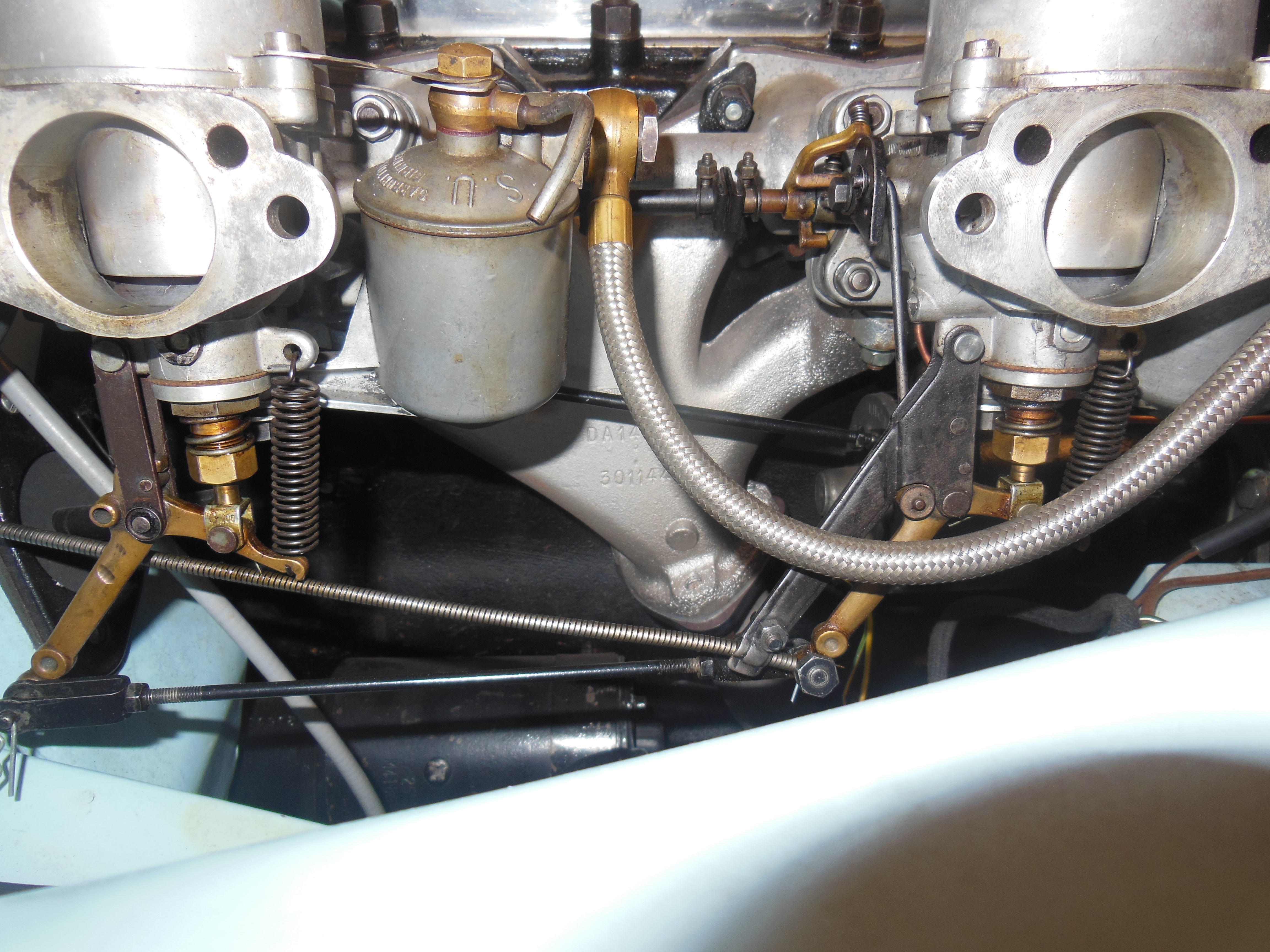

Very clean engine rebuild! I like the fresh rockers and braided stainless fuel lines.

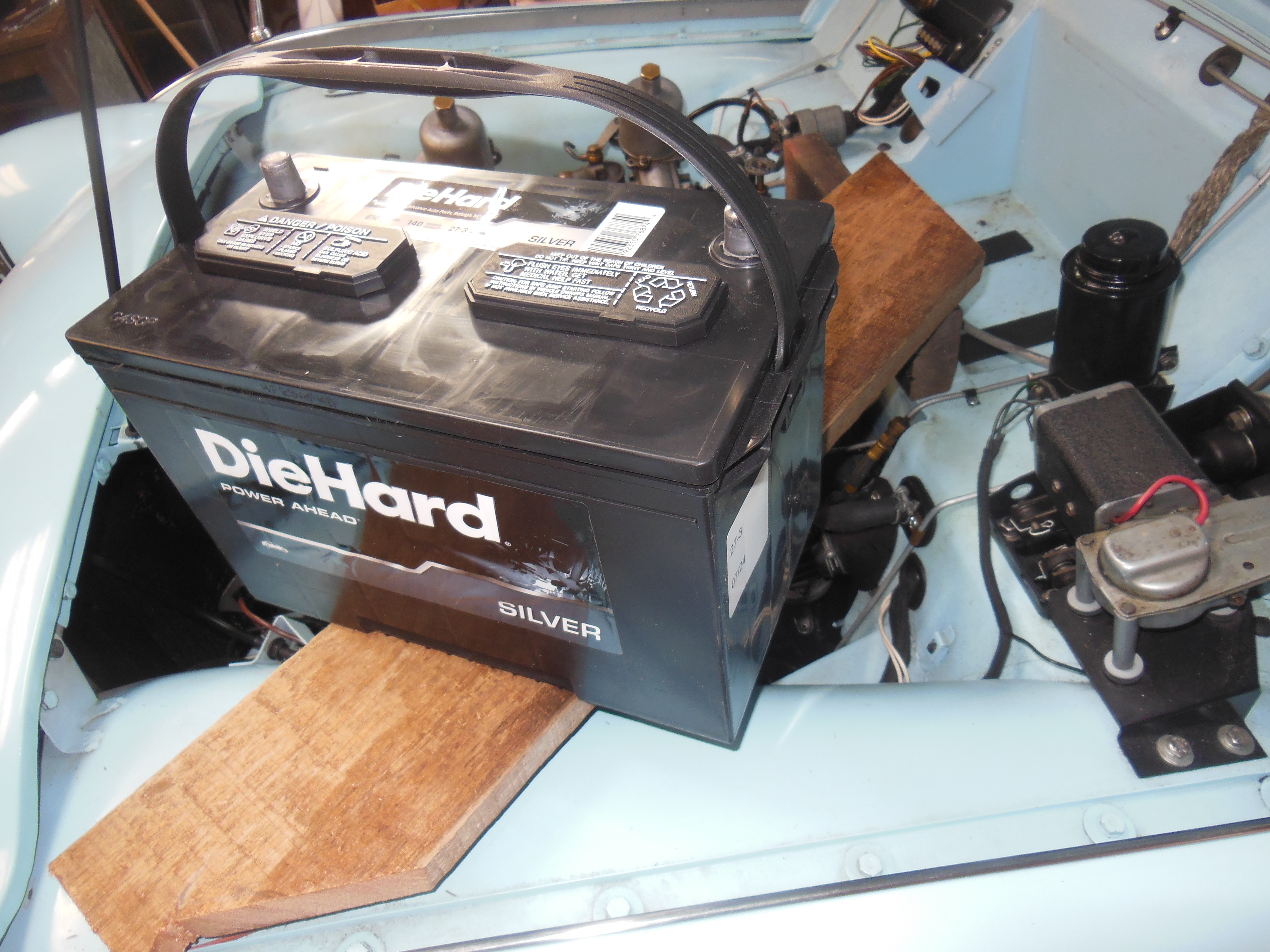

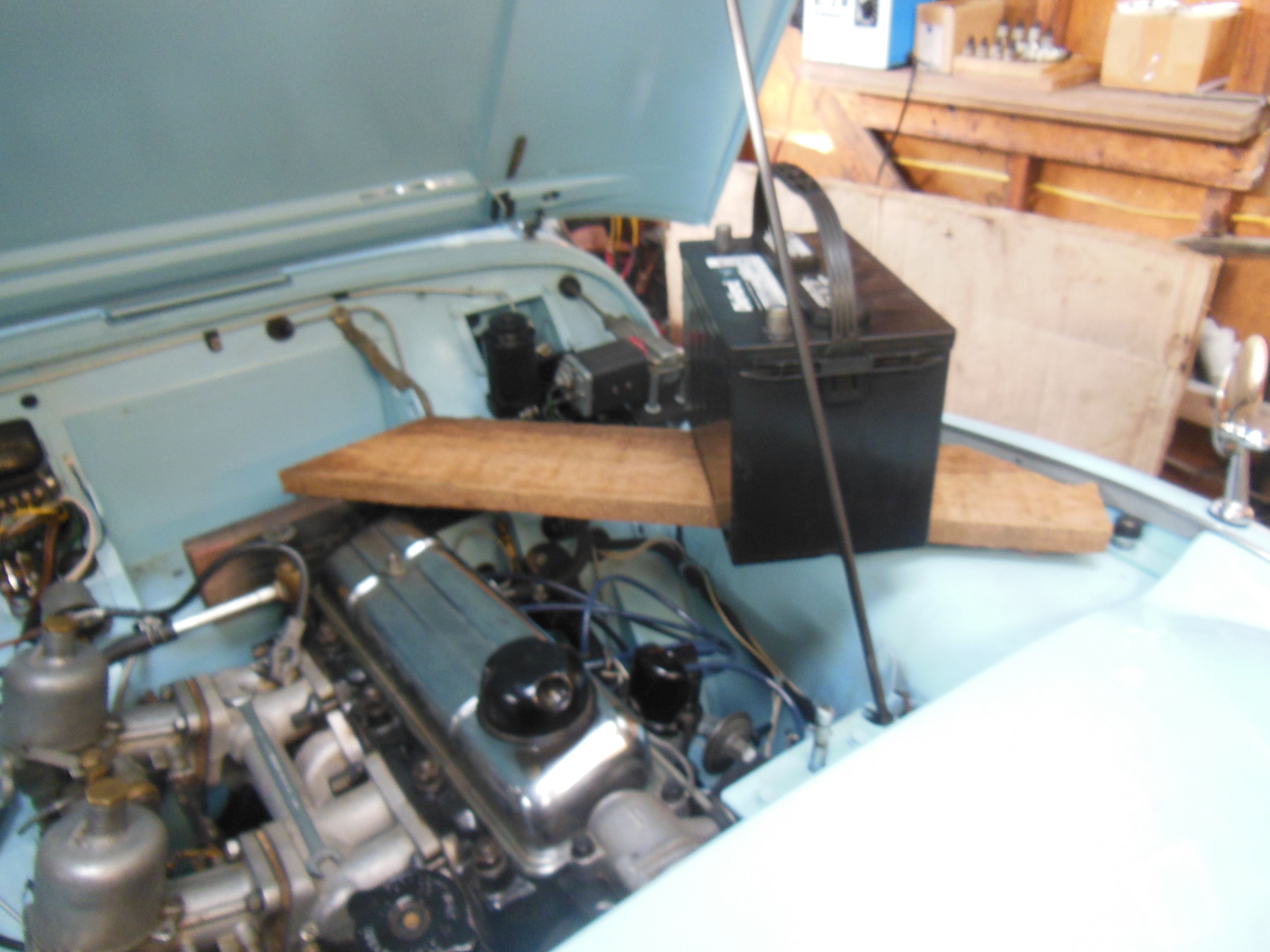

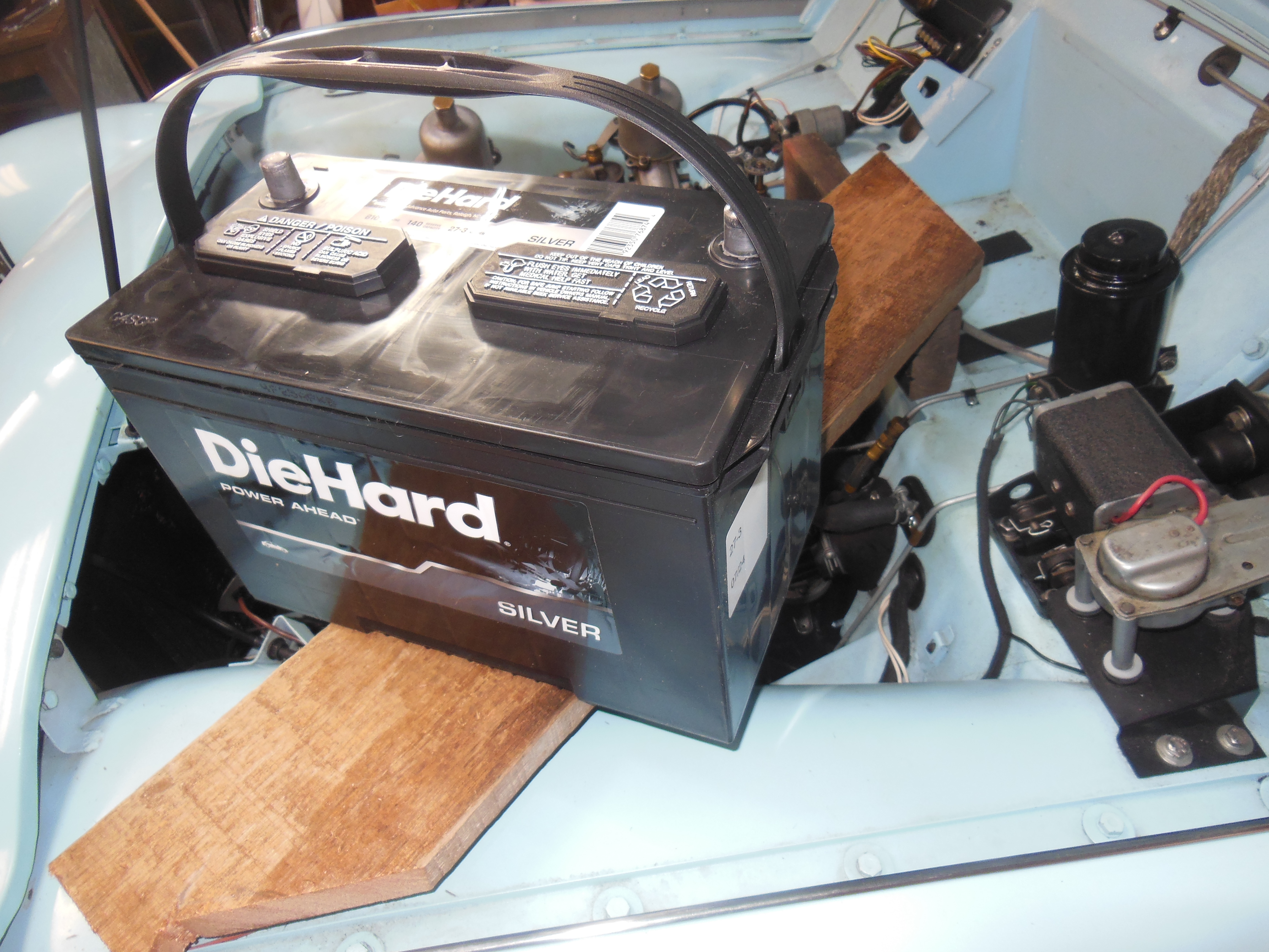

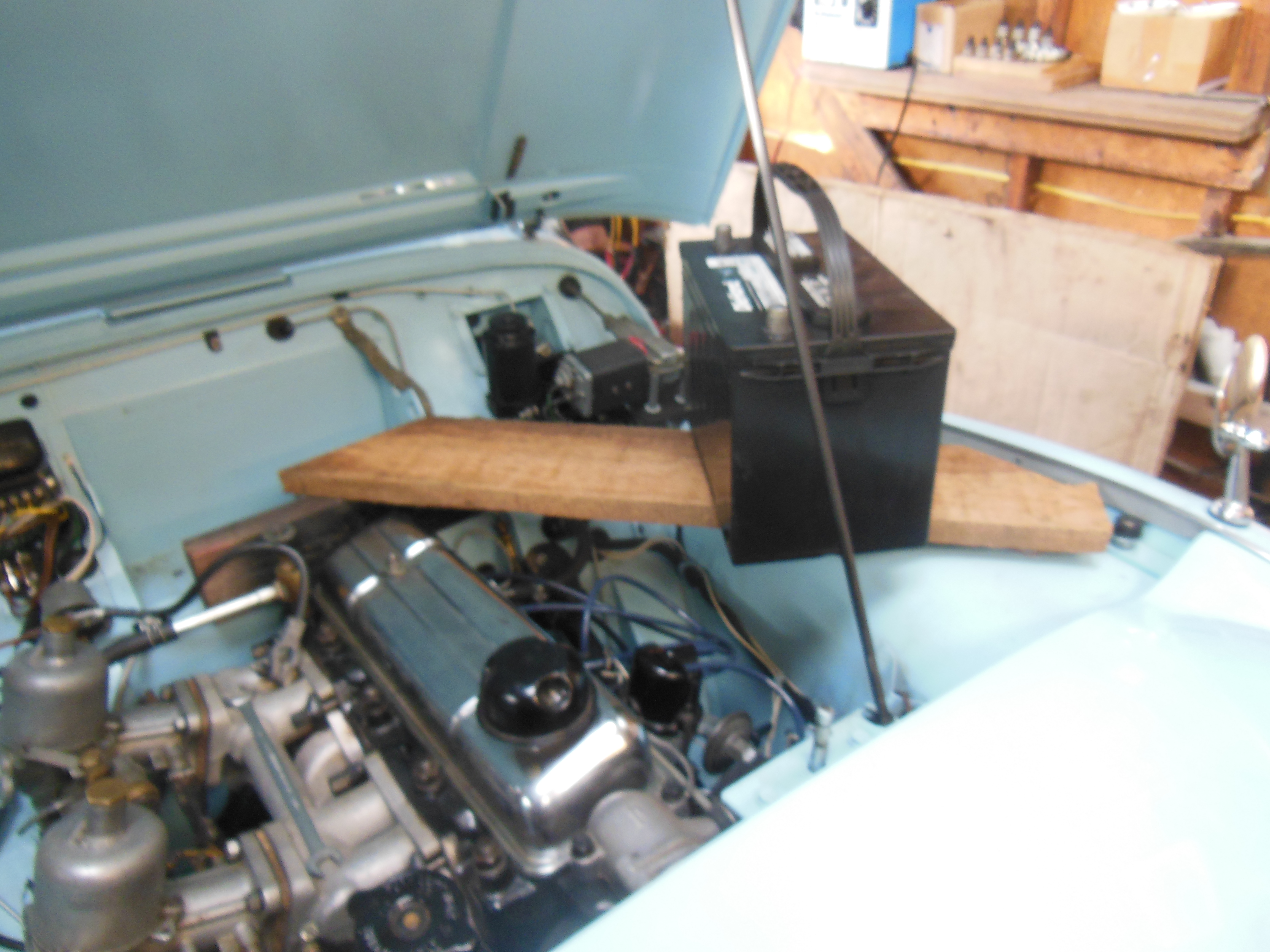

The car might be coming around. I put in a new battery yesterday because something in the starting system was not doing its job. I went with the battery idea first because it was a Cosco 2019---- ended up with a Diehard #27. The battery looks good and cranked the car right over. I am glad that it was not the boob starter. Anyways found a station with 92 octane and filled it. I will try some starting without the starter fluid, but I do not want to wear down the starter for no good reason.
Thanks Poolboy for the clarification on 4th gear. I kinda knew that, but I have never followed the pinging theory out to the end. After setting the timing with a trouble light, I am going to follow the idea through.
Setting the timing by listening to the engine in 4th on a hill should be some finer tuning and I think this car might need that and to be driven more. I am planning to drive it every day for month or until it starts starting better
PS All I have a patent pending battery slide and a sore back.
